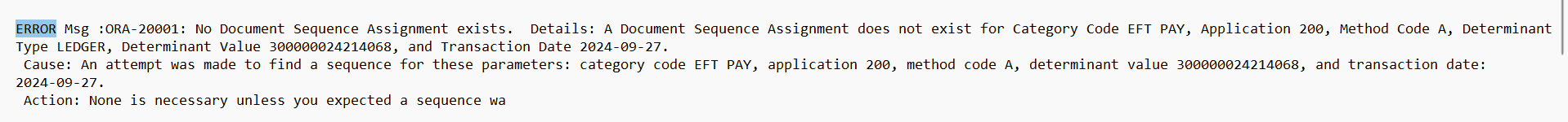

After that when payment process request is submitted, at the time of payment file formatting stage, the formatting fails as below and it has error message as below.
We checked with SR analyst and we did not get expected response. But question is, when document sequencing is not enforced in AP, why payment formatting fails with this above error ? The moment, we change the ledger options sequencing by as No sequencing, this works as expected. Has anyone faced this before? Are there any additional configs to check ?
