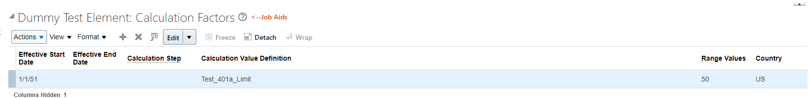

This is the custom Calculation Value Definition that I created:

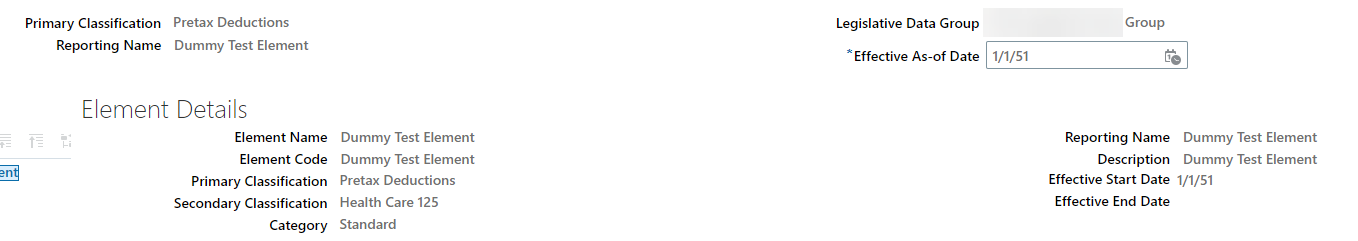

Here are the details on the element:
I've add the Calculation Value Definition at the element level under Calculation Factors.
I created an element entry on an employee with the new element with an amount of $98.00. Then I processed a QuickPay and confirmed that the full $98 were deducted instead of the $50. Do you have any guidance on what else I need to setup? If so, please provide guidance along with the navigation. Thank you in advance!
