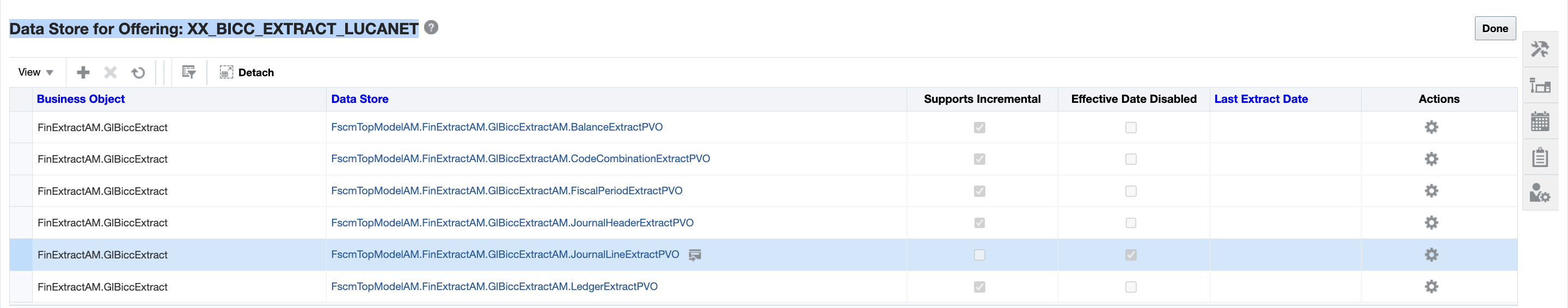

In the Oracle Business Intelligence Cloud Connector (BICC) Console, the Support Incremental option is enabled under Manage Job for FscmTopModelAM.FinExtractAM.GlBiccExtractAM.JournalLineExtractPVO. However, the export process is still generating some duplicate records.
Upon investigation, I found that the FscmTopModelAM.FinExtractAM.GlBiccExtractAM.JournalLineExtractPVO data store is customized, and the only visible customization is that the Disable Effective Date Filter option is checked. Additionally, the PVO under Data Offering is not marked as supporting incremental extraction.
Now, I am unsure whether simply unchecking the Disable Effective Date Filter option would resolve this issue. Or do I need to take additional steps, such as
