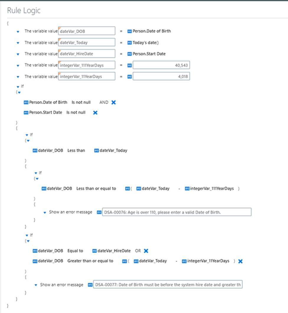

Summary:
Autocomplete Rule: Error message not showing properly in External Career Site > Post Apply Flow 1.5 Application
We have an autocomplete rule error for Person Date of Birth. Error message should trigger when Date of Birth is beyond 110 years or below 10 years old from today.
Error Message should be:
DSA-00076: Age is over 110, please enter a valid Date of Birth.
Instead this is the error message:
"Your application couldn't be submitted. Please try again."
Version (include the version you are using, if applicable): 25A
Code Snippet (add any code snippets that support your topic, if applicable):
