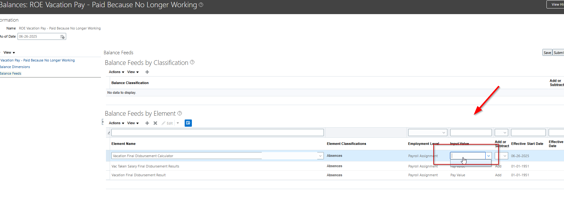

when we run the ROE for our terminated employees, vacation final payments are not showing in the ROE box 17.
I have read the configuration document:
The document says to use the Vacation Payout Calculator and not the Vacation Payout Results in the balance definition
But when I check the element, the element does not show any insurable input value
Therefore, when I try to add the calculator element to the balance definition, there is no input value for me to add:
How can we include the final vacation payment in Box 17 of the request for ROE?
