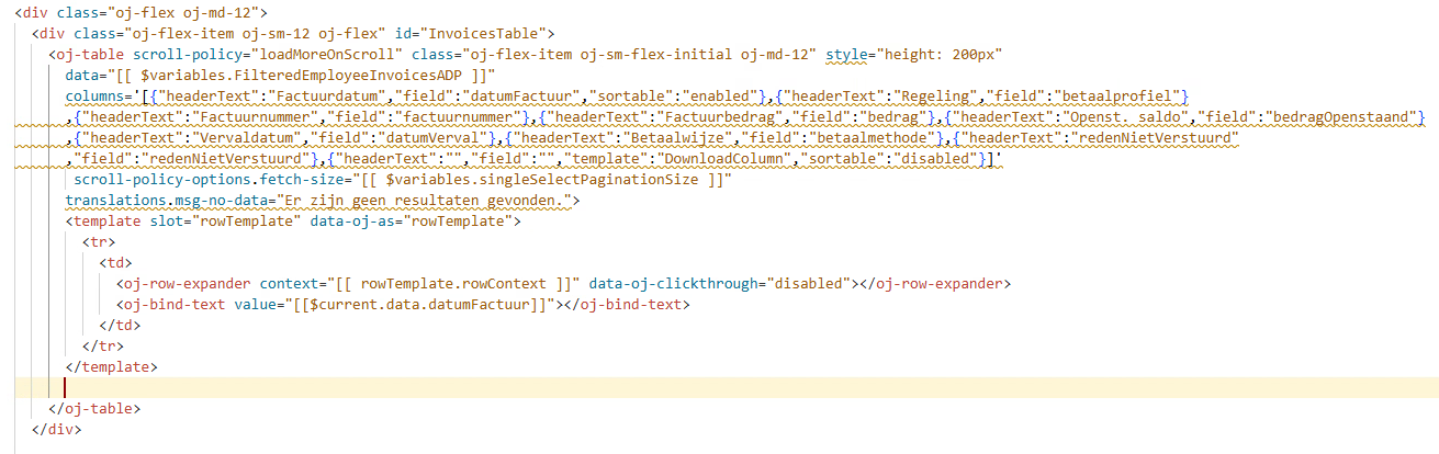

I want a table. Where each row is expandable.
I am following this guide:
Table | Detail Row with Tree Data | JET Developer Cookbook
But without success.

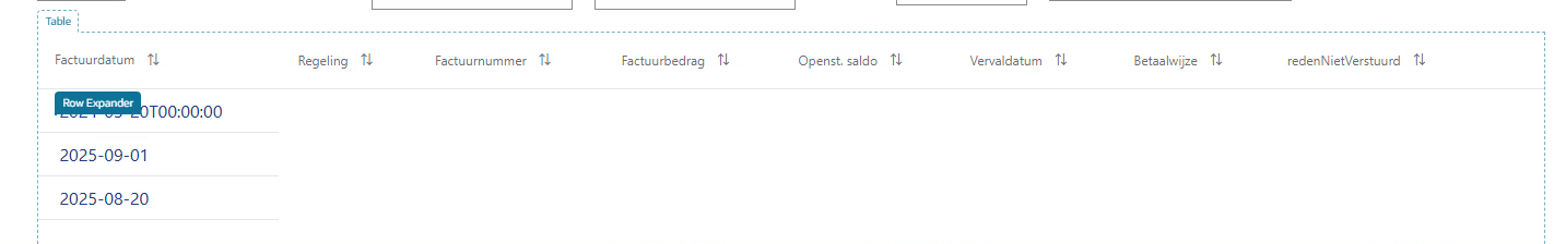

I cannot get the " rowExpander" visible in any way.
Do you have any recommendation what to change?
