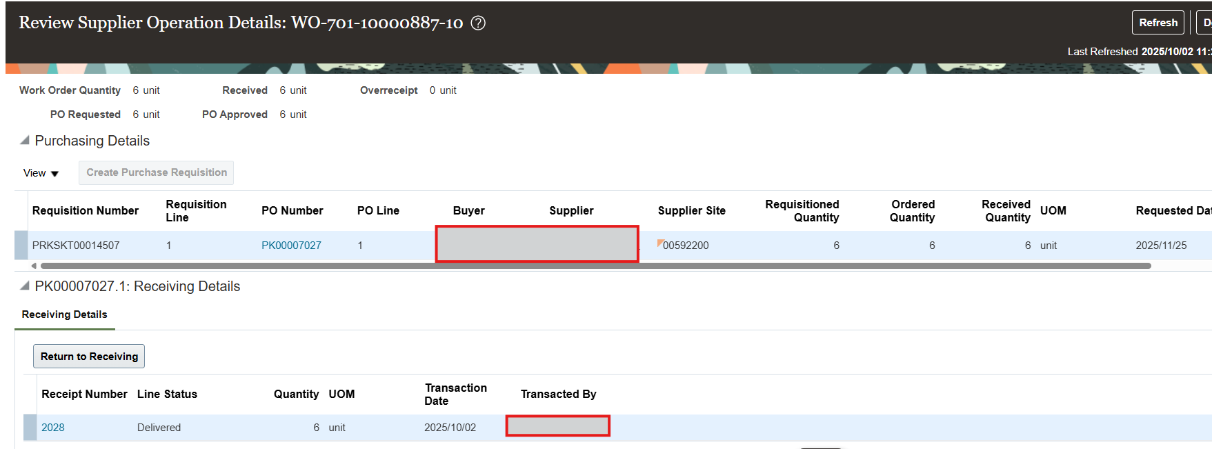

When user received OSP PO, the related WO(serial unit) did not happen backflush even the supply type is set operation-pull.
So I would like to know how the supplier opertaion of serialized WO make backflush transaction when OSP PO receiving?
Details are below contents.
This is work order for serial item.
And the item 60031805 has supply type =Operation pull
PO receving

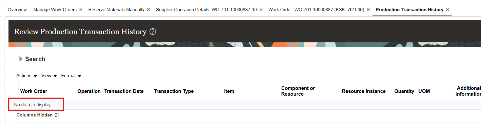

But no transaction for wip issue in transation history.
