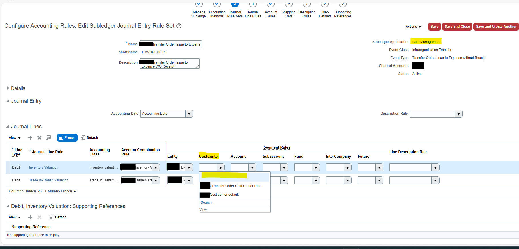

While trying to configure the above for Cost Accounting, when we add Project ID in Account Rule conditions, the account rule is unavailable when trying to add to the JERS.
Is there any way to use Project based conditions in Cost Accounting Rules?
Account Rule created:
JERS where it is not available
