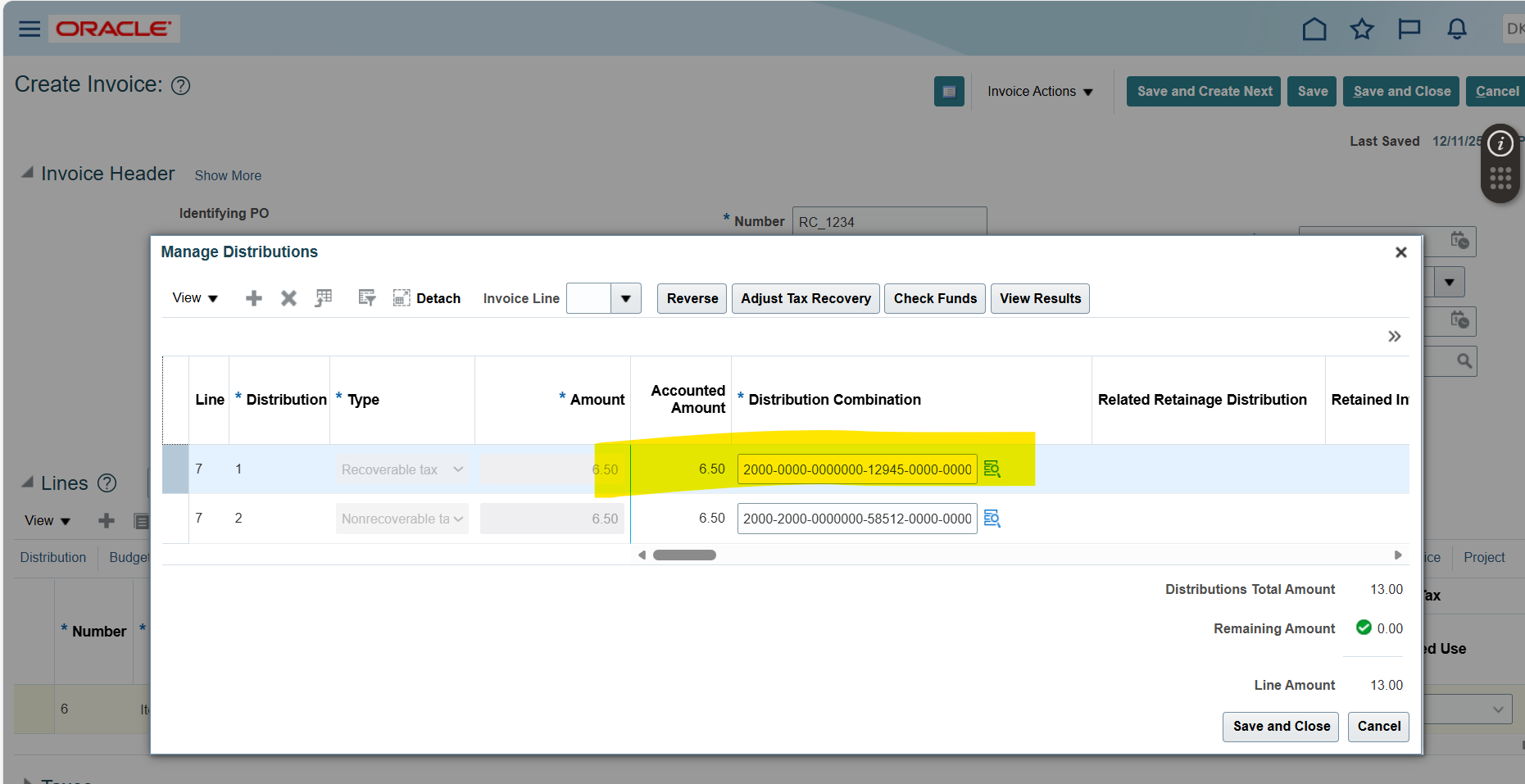

We have a requirement to allow user to manaully override the Recovery tax rate at the AP invoice line level. User is able to override the Recovery tax rate, but after overriding also distribution combination is not getting updated as per the new Recovery rate. Is there any setup/option that needs to be enabled to update the distribution combination as per the new Recovery tax rate.
Default recovery rate and distribution:
Distribution:

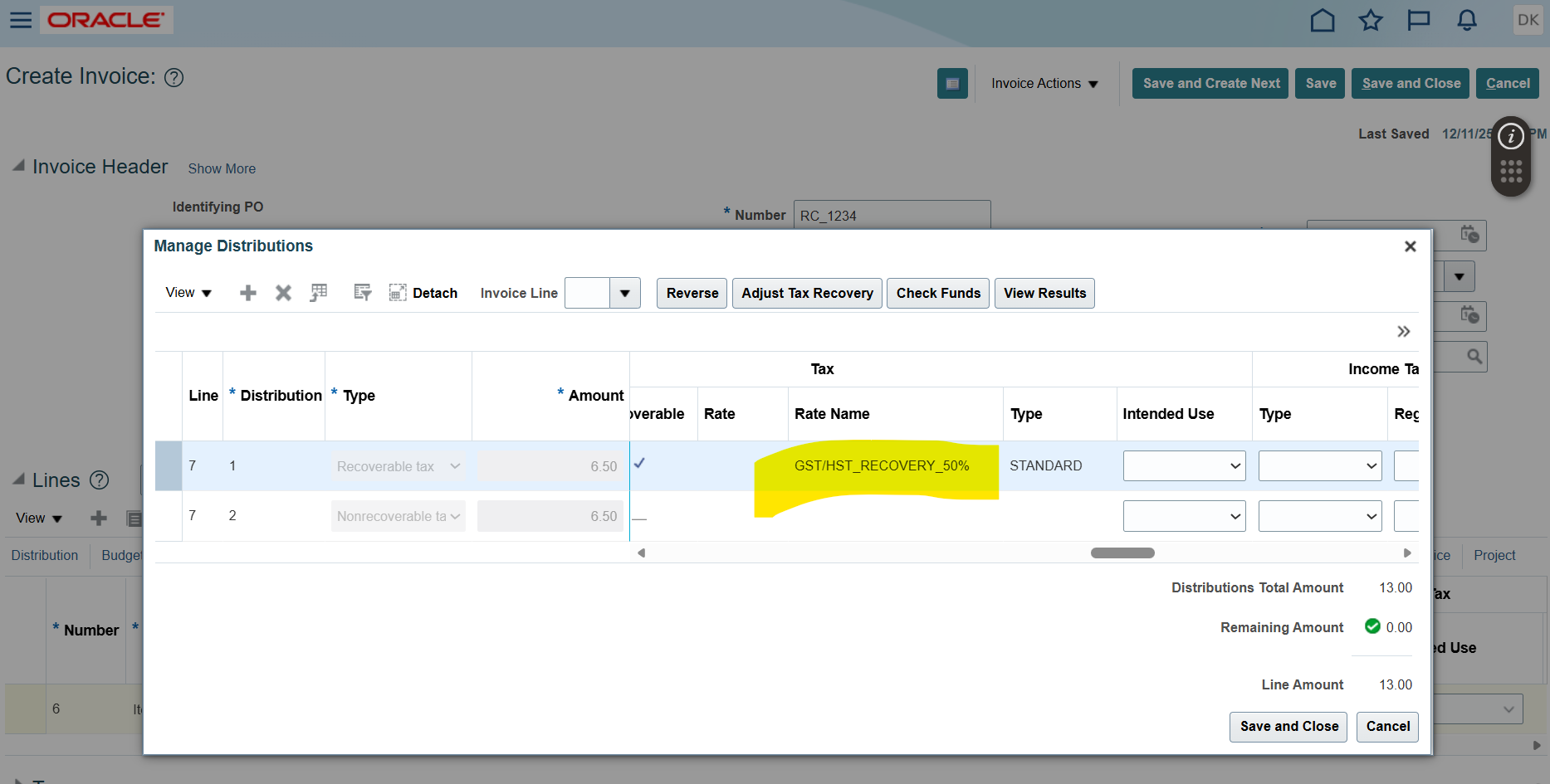

Tax rate:
Newly selected Recovery tax rate:
still distribution is not getting updated as per the account that is used for this 50% recovery rate:
Config: Tax account at the above two recovery tax rate levels:
