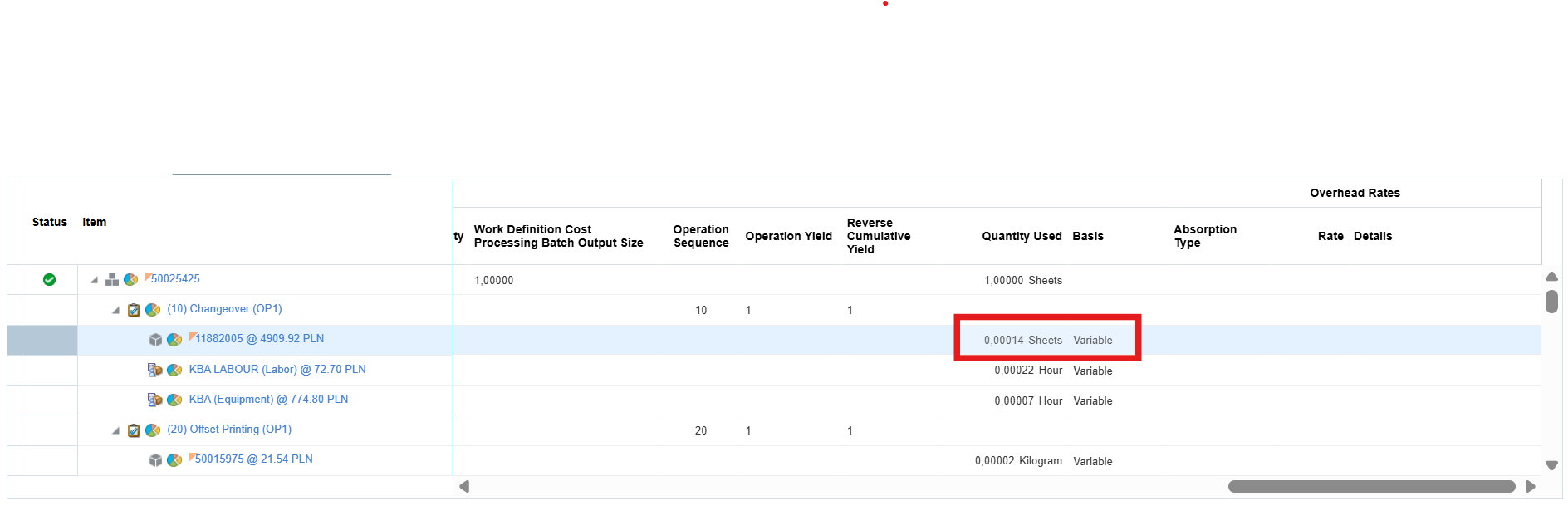

Need clarification on the extracted data from the View Rolled up Costs in Classic UI
The quantity displayed is based on the costing UOM where as the displayed UOM aligns with the Work Definition.
Item in Cost Definition: 11882005 - 4909.92PLN / Metric Ton
Item in Work Definition: 11882005 - 52.2475 Sheets
Sheets to Metric Ton (Inter Class and Intra Class conversions are in place)
However, in the cost roll-up extract, the Quantity Used value is displayed this way.
The numerical value represent the quantity in Costing UOM (metric ton) but the UOM displayed is based on WD(Sheets)
Can you please help with this clarification? We need this to validate the cost rollup with respect to the legacy data and this output is a bit confusion. Any help would be appreciated!
