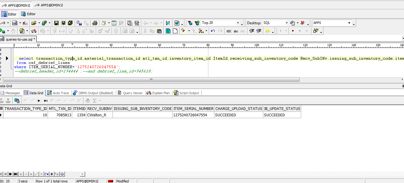

    Hi Jon,
    Thanks a ton for your time and tries to help on this!
    I did verify first two oracle notes as they seemed close but doesn't seem like either of them.
    For 2nd one, as well there is only one debrief line for the specific serial and no duplicate found for it.
    Please check the uploaded snap.
    Further, if you observe my 1 st upload (.doc) , the exact issue is the page getting greyed- out because of which service engineers could not make changes to material lines. Hence i thought clearing this "No instance found...." issue may flip the debrief status so that users can go back, make changes and resubmit it.Only One Debrief Line found for the specific Serial #1275240726047554.PNG
    Thanks a ton!
    Kind Regards,
    Sriram
