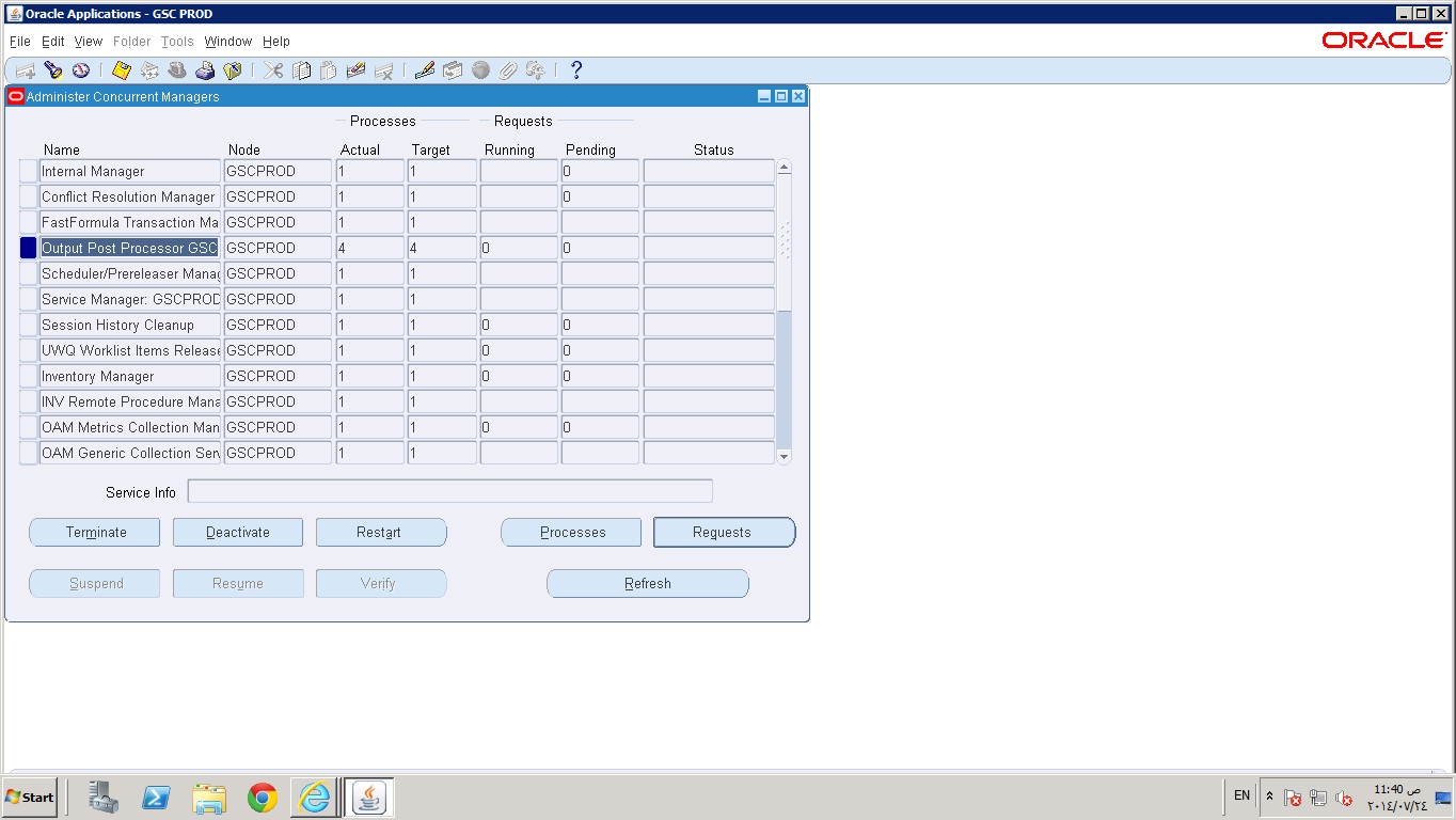

    When i run a report it gives me this log :

  • User_1K4DF
    User_1K4DF Posts: 11 Blue Ribbon
    SQL> select CONCURRENT_QUEUE_NAME, ENABLED_FLAG, MAX_PROCESSES, RUNNING_PROCESSES
      2  from FND_CONCURRENT_QUEUES
      3  WHERE CONCURRENT_QUEUE_NAME='FNDCPOPP';
    CONCURRENT_QUEUE_NAME          E MAX_PROCESSES RUNNING_PROCESSES
    FNDCPOPP                       Y             4                 4
    SQL> select CONCURRENT_QUEUE_NAME, TARGET_NODE, node_name, control_code
      2   from fnd_concurrent_queues
    CONCURRENT_QUEUE_NAME          TARGET_NODE
    NODE_NAME                      C
    FNDCPOPP                       GSCPROD
    GSCPROD
    SQL> SELECT outfile_name, outfile_node_name
      2  FROM fnd_concurrent_requests
      3  WHERE request_id = 503291;
    OUTFILE_NAME
    OUTFILE_NODE_NAME
    /u01/oracle/PROD/inst/apps/PROD_gscprod/logs/appl/conc/out/o503291.out
    GSCPROD

    Hi,
    A. 1. Navigate to Concurrent Manager Administer -> Select the Output Post Processor.
    2.  Click the "Processes" button.  Select the process that was active
    3.  Choose the "Manager Log" button and upload this log
    B. Navigate to Concurrent Manager Administer and upload the screen shot <make sure OPP manager shows from this screen shot>.
    C. Upload the internal manager log file
    Regards,
  • User_1K4DF
    Hii,
    This is the Manager Log :

    This is the internal Manager Log :
    Starting PROD_0717@PROD Internal Concurrent Manager -- shell process ID 22328
      logfile=/u01/oracle/PROD/inst/apps/PROD_gscprod/logs/appl/conc/log/PROD_0717.mgr  PRINTER=noprint  mailto=oracle  restart=N  diag=N  sleep=30  pmon=4  quesiz=1  Reviver is ENABLED
    Routine &ROUTINE has attempted to start the internal concurrent manager. The ICM is already running. Contact you system administrator for further assistance.afpdlrq received an unsuccessful result from PL/SQL procedure or function FND_DCP.Request_Session_Lock.
    Routine FND_DCP.REQUEST_SESSION_LOCK received a result code of 1 from the call to DBMS_LOCK.Request.
    Possible DBMS_LOCK.Request resultCall to establish_icm failed
    The Internal Concurrent Manager has encountered an error.
    Review concurrent manager log file for more detailed information. : 17-JUL-2014 12:56:33 -
    Shutting down Internal Concurrent Manager : 17-JUL-2014 12:56:33
    List of errors encountered:
    _ 1 _
    Routine AFPCSQ encountered an ORACLE error. .
    Review your error messages for the cause of the error. (=<POINTER>)
    _ 1 _
    Routine AFPCAL received failure code while parsing or running your
    concurrent program CPMGR
    Review your concurrent request log file for more detailed information.
    Make sure you are passing arguments in the correct format.
    The PROD_0717@PROD internal concurrent manager has terminated with status 1 - giving up.
    Shutting down Internal Concurrent Manager : 17-JUL-2014 12:56:42
    The PROD_0717@PROD internal concurrent manager has terminated successfully - exiting.
    Starting PROD_0717@PROD Internal Concurrent Manager -- shell process ID 23720
    Application Object Library: Concurrent Processing version 11.5
    Copyright (c) 1979, 1999, Oracle Corporation. All rights reserved.
    Internal Concurrent Manager started : 17-JUL-2014 13:05:32
      Process monitor session started : 17-JUL-2014 13:05:32
    Starting FFTM Concurrent Manager : 17-JUL-2014 13:05:32
    Starting INVTMRPM Concurrent Manager : 17-JUL-2014 13:05:32
    Starting RCVOLTM Concurrent Manager : 17-JUL-2014 13:05:32
    Starting PODAMGR Concurrent Manager : 17-JUL-2014 13:05:32
    Starting XDP_Q_ORDER_SVC Concurrent Manager : 17-JUL-2014 13:05:32
    Starting OAMGCS_GSCPROD Concurrent Manager : 17-JUL-2014 13:05:33
    Starting XDP_SMIT_SVC Concurrent Manager : 17-JUL-2014 13:05:33
    Starting XDP_Q_TIMER_SVC Concurrent Manager : 17-JUL-2014 13:05:33
    Starting XDP_Q_IN_MSG_SVC Concurrent Manager : 17-JUL-2014 13:05:33
    Starting XDP_Q_EVENT_SVC Concurrent Manager : 17-JUL-2014 13:05:33
    Starting XDP_Q_FE_READY_SVC Concurrent Manager : 17-JUL-2014 13:05:33
    Starting XDP_Q_FA_SVC Concurrent Manager : 17-JUL-2014 13:05:33
    Starting XDP_Q_WI_SVC Concurrent Manager : 17-JUL-2014 13:05:33
