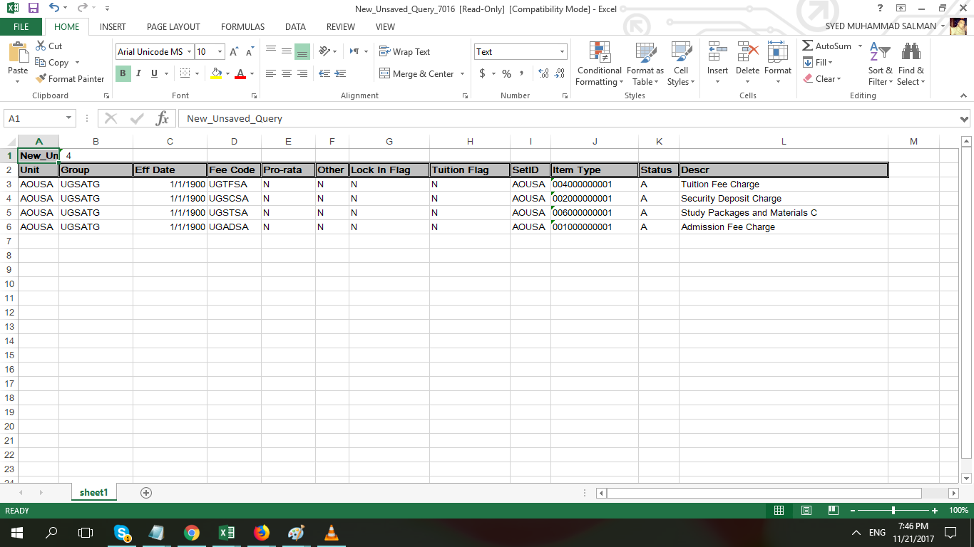

    Hi ,
    For each item type used in the fee structure on the Under-Graduate Saudi Campus Tuition group , It is active , I had checked all item typesitem type attached with Tui group.png

    Hi ,
    Thank you for checking the item types used in the tuition group are active.  A COBOL trace of the tuition calculation process will be required.  The instructions to obtain a remote call COBOL trace are below.  Since setting a trace file at the application server will trace any remote call process executed while tracing is in effect, it is recommended that tracing activities be performed on a test environment.  You may consider opening a service request for the reported issue, and attaching the trace files to the service request.
