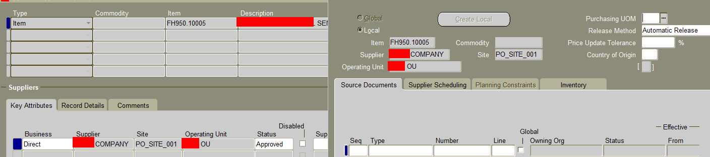

My ASL:

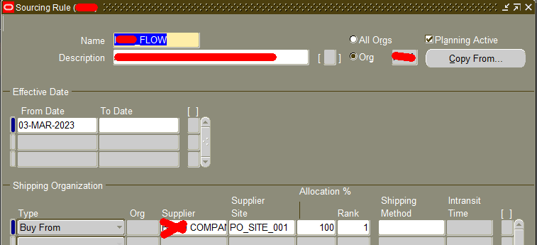

My sourcing rule:

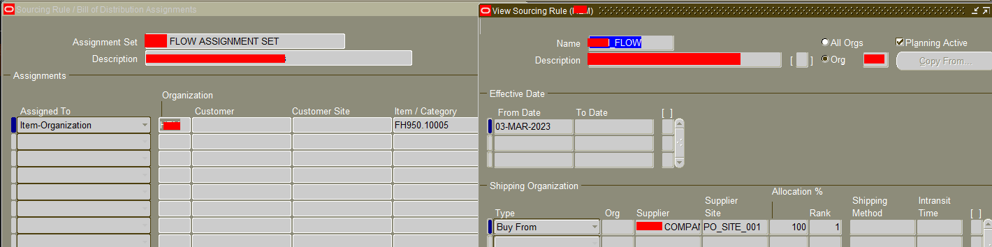

My assignment set:
