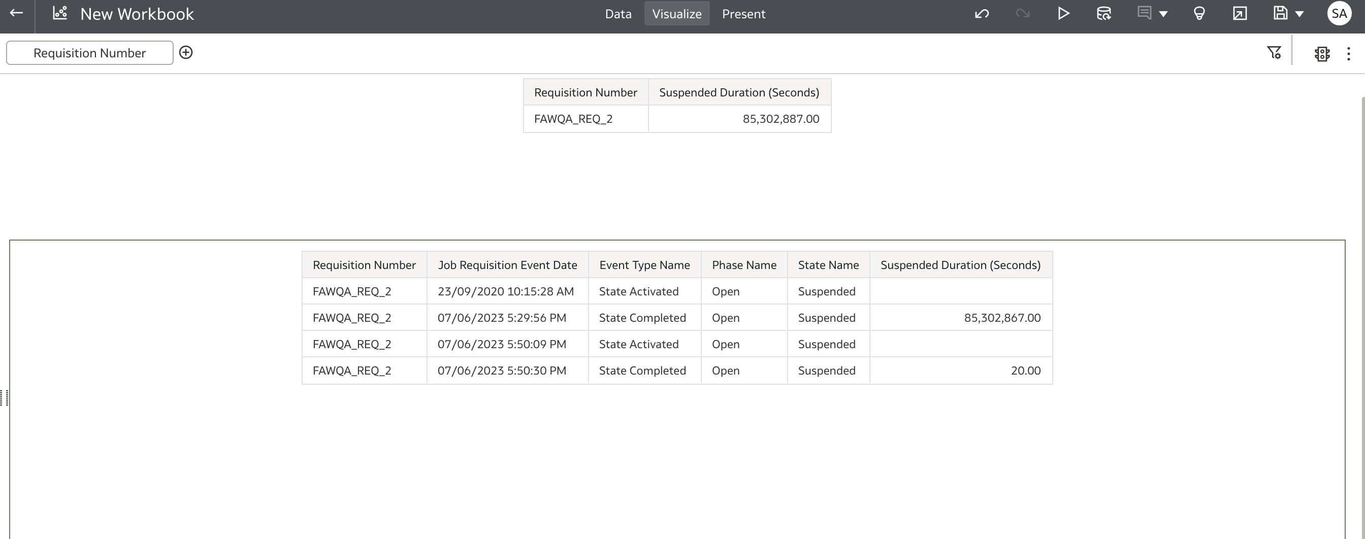

    The "Suspended Duration" field has been introduced in the recent R3 upgrade.
    Nonetheless, we've observed that the field only reflects the last instance of suspended days. If there are multiple suspended states, the days are not compounded.
    This doesn't appear to align with the proposed initial use case. Or is this still a work in progress?
    Rgds,
    LipLooi
  • Hi LipLooi,
    thank you for testing this and reaching out to me. I think you might be missing something here. I created a similar report where a specific requisition has gone through 'suspended' state twice with different intervals. Against the requisition, the cumulative suspended duration value is displayed(the viz on top). When i bring in the event details, the duration is split . Refer the attached screenshot. Can you please try something similar at your end?
    Raghu
  • LipLooi
    LipLooi Rank 3 - Community Apprentice
    Hi Raghu,
    Yes! This is helpful and explains. I figured out the filter I have for the workbook cause the other suspended day not showing. Thank you so much!!
    Rgds,
    LipLooi
