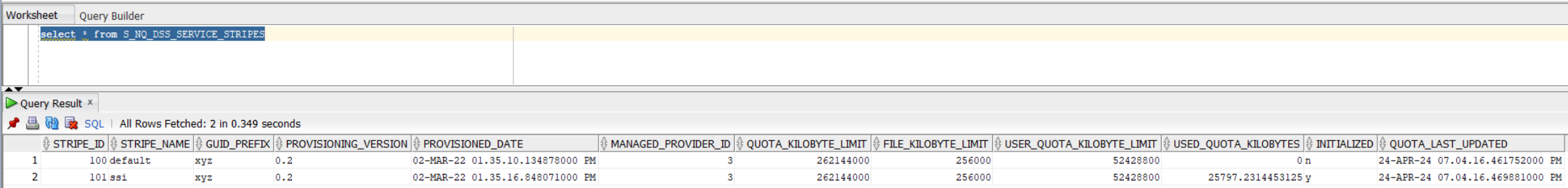

    I checked BI_BIPLATFORM.S_NQ_DSS_SERVICE_STRIPES table and I see only one row , attached the screen shot of the same(missing_ssi_info.jpg).

    As per uploaded screenshot , S_NQ_DSS_SERVICE_STRIPES table should have 2 Entries.
    It should have two records in it:
    STRIPE_ID, "100" STRIPE_NAME, "DEFAULT" ...
    and
    STRIPE_ID, "101" STRIPE_NAME, "SSI" ...
    Insert manually another record to fix the issue.

    Thanks @Mallikarjuna Kuppauru-Oracle,
    I did entered the value and triggered dss_storage_plugin export was successful however it failed in another point(i.e., OfflineJaznContentPlugin)
