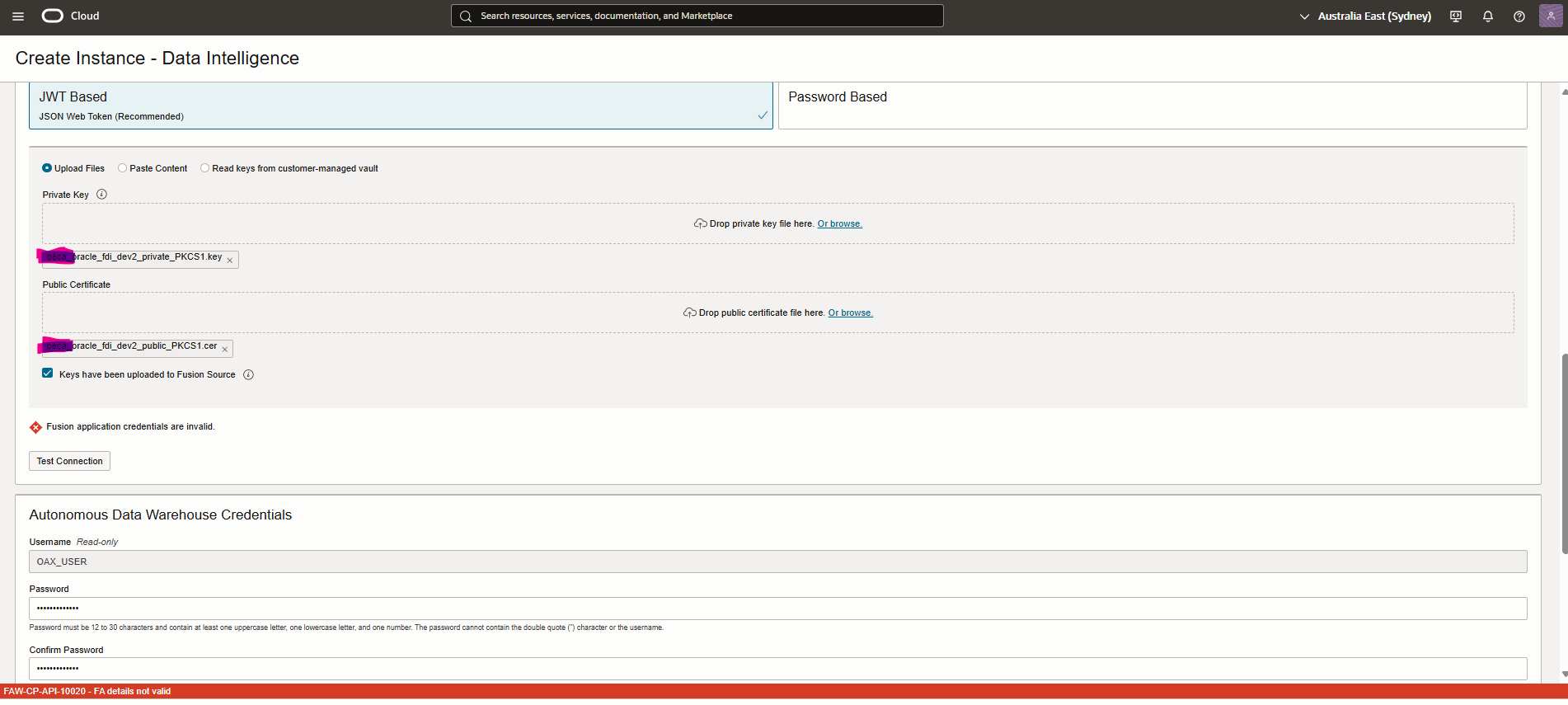

@RajeshPolavarapu-Oracle @Victor H
We’re in the process of recreating the FDI Non-Production instance using an alternate domain(DEV2), rather than the default
Default-Identitydomain. However, we've encountered a roadblock during the JWT token configuration.Although the certificates have been correctly updated in Fusion Applications and we've allowed a 30-minute wait time, the instance creation continues to fail. The error message indicates that the Fusion Application credentials are invalid.
Could you please advise on how to proceed?
Error Code: FDI FAW CP API 10020 Error
