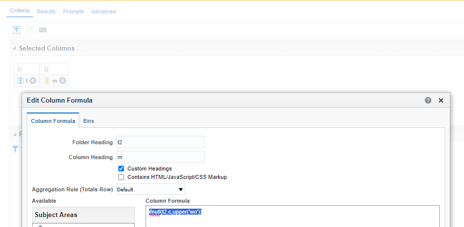

    Hi On the advanced tab is the logical SQL from above with the left outer join with the cols t and m from the select bit of that SQL on the criteria tab with the formula on col m on the fact measure string.

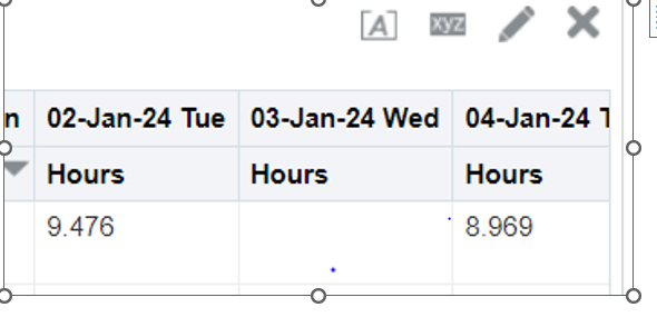

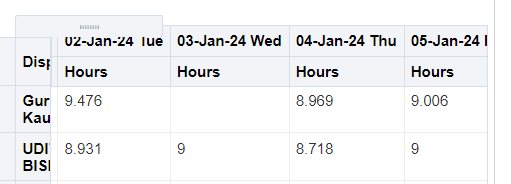

    But looking at your screen shot it is perhaps a "pivot table" in which case the "blank" as you call it is "no rows at all" for that day for that row in the pivot table so no matter what you do in your case statement it will not work because you have no row returned in the result set from your query. So if you did a left outer join from the calendar dimension so you will always get a row for each day whether a timecard entry exists or not then only will the case statement approach work.
    At the moment in yout table view you have 2 rows?
    dimension X tue 9.476 hurs
    dimension X thu 8.969 hours
    (no row in the table for wed for dimension X)
    but lower down in the table another row
    dimension Y wed 9.99 hours
    so in the pivot table for the row for dimension X there is no value in Wed?
  • User_RD03L
    User_RD03L Rank 4 - Community Specialist
    Hello Nathan,
    Thank your for the detailed explanation. Indeed, I have 2 rows on my table view
    Yes, I confirm that pivot table in dimension X has no value on Wed.

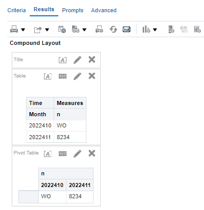

  • Nathan CCC
    Nathan CCC Rank 7 - Analytics & AI Coach
    edited Oct 2, 2024 12:40PM
    Hi,
    Here is a pivot showing a month for which we have no timecards as "WO" and another that does have timecards.
    SQL with left outer join
    select t1.t
    , ifnull(t2.c,upper('wo')) as m
    from
    select all "Time"."Calendar Month" as t
    from "Workforce Management - Reported Time Cards Real Time"
    ) t1
    left outer join
    , "Reported Time Cards"."Reported Hours" as n
    , cast("Reported Time Cards"."Reported Hours" as character) as c
    ) t2
    on (
    t1.t = t2.t
    where 1 = 1
    and (t1.t in ('2022411','2022410'))

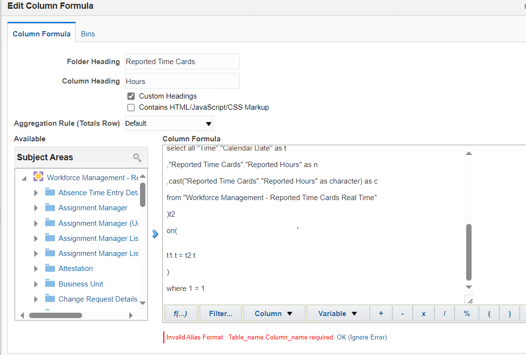

    Hello,
    After applying the sql in the reported hours column, I'm encountering an error.
    select t1.t
    ,ifnull(t2.c,upper('wo')) as m
    from
    select all "Time"."Calendar Date" as t
    )t1
    left outer join
    ,"Reported Time Cards"."Reported Hours" as n
    ,cast("Reported Time Cards"."Reported Hours" as character) as c
    )t2
    on(
    t1.t = t2.t
    where 1 = 1
  • Nathan CCC
    Hi,
    Sorry I did not understand what you meant by "may I know in which column did you add it on?"
    You cannot cut paste SQL into the "Edit Formula" of a column in an analysis. I did not edit any column.
    This is the logical SQL that you generated on your advanced tab. So you can edit it there on your advanced tab.
    Or create a new query using Create, Analysis, "Create analysis from simple logical SQL"
