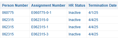

This is from the analysis for just the employee information that works (before trying to add job or position):
SET VARIABLE PREFERRED_CURRENCY='User Preferred Currency 1';SELECT
0 s_0,
"Workforce Management - Areas of Responsibility"."Worker"."Assignment Number" s_1,
"Workforce Management - Areas of Responsibility"."Worker"."HR Status" s_2,
"Workforce Management - Areas of Responsibility"."Worker"."Person Number" s_3,
"Workforce Management - Areas of Responsibility"."Worker"."Termination Date" s_4,
DESCRIPTOR_IDOF("Workforce Management - Areas of Responsibility"."Worker"."HR Status") s_5
FROM "Workforce Management - Areas of Responsibility"
WHERE
((DESCRIPTOR_IDOF("Workforce Management - Areas of Responsibility"."Worker"."HR Status") <> 'ACTIVE') AND ("Worker"."Assignment Number" NOT LIKE 'P%') AND ("Worker"."Termination Date" >= (CURRENT_DATE - 30)))
ORDER BY 4 ASC NULLS LAST, 2 ASC NULLS LAST, 3 ASC NULLS LAST, 6 ASC NULLS LAST, 5 ASC NULLS LAST
FETCH FIRST 75001 ROWS ONLY
This results is this:

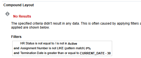

Then I try to add Position Code (but also data from job, department, and organization) where it did not work:
0 s_0,
"Workforce Management - Areas of Responsibility"."Position"."Position Code" s_1,
"Workforce Management - Areas of Responsibility"."Worker"."Assignment Number" s_2,
"Workforce Management - Areas of Responsibility"."Worker"."HR Status" s_3,
"Workforce Management - Areas of Responsibility"."Worker"."Person Number" s_4,
"Workforce Management - Areas of Responsibility"."Worker"."Termination Date" s_5,
DESCRIPTOR_IDOF("Workforce Management - Areas of Responsibility"."Worker"."HR Status") s_6
WHERE
ORDER BY 5 ASC NULLS LAST, 3 ASC NULLS LAST, 4 ASC NULLS LAST, 7 ASC NULLS LAST, 6 ASC NULLS LAST, 2 ASC NULLS LAST
The result is this:
