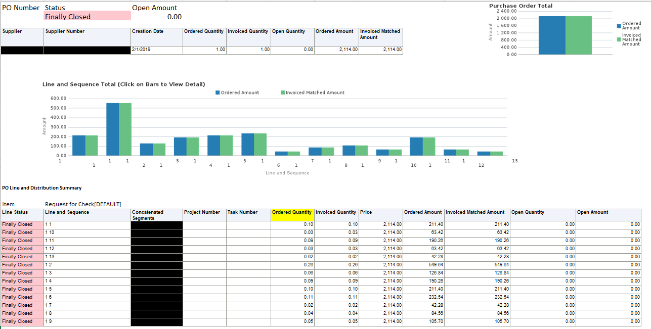

    Hi,
    See if this works in your instance, you may need both line and distribution sequence for it to appear.
    You also mentioned about blank, double check you currency settings from the catalog my account → preferences → currency. In our instance I set to ledger currency.
    Attached is the xml (you can go to advanced and replace what is in the analysis xml and click apply). I have defaulted PO as a filter, so you can modify that as needed/etc.
    Also attaching archive file that you could also unarchive in your instance.
    Hope this helps/works.
  • Sudheer YN
    Sudheer YN Rank 4 - Community Specialist
    Thank you @Rich Merkel . I have created an SR and working with them. Its showing null because of 3 columns Requester, Project Number and Expenditure Organization columns. If i remove these columns from my report, its showing ordered qty.
