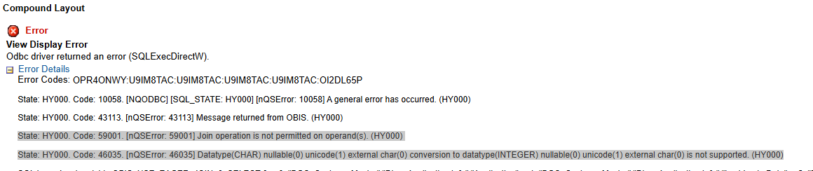

OBIEE 12C Analysis/Dashboard is giving below error:
State: HY000. Code: 59001. [nQSError: 59001] Join operation is not permitted on operand(s). (HY000)
State: HY000. Code: 46035. [nQSError: 46035] Datatype(CHAR) nullable(0) unicode(1) external char(0) conversion to datatype(INTEGER) nullable(0) unicode(1) external char(0) is not supported. (HY000)
