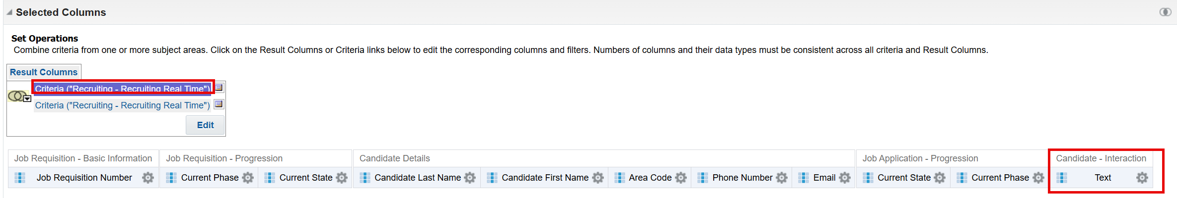

I attempted to use a UNION through Set Operations (https://docs.oracle.com/en/cloud/saas/otbi/otbi-user/advanced-techniques-combine-columns-display-data-differently.html). In the first analysis (the primary one), I included "Text" column from "Candidate – Interactions" folder:

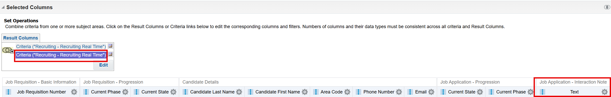

For the second set, I added the exact same columns as in the main analysis. The only difference is that the "Text" column was pulled from the "Job Application – Interaction Note" folder. I applied SUBSTRING("Candidate - Interaction"."Text" FROM 1 FOR 4000) formula to both Text columns to clear format:

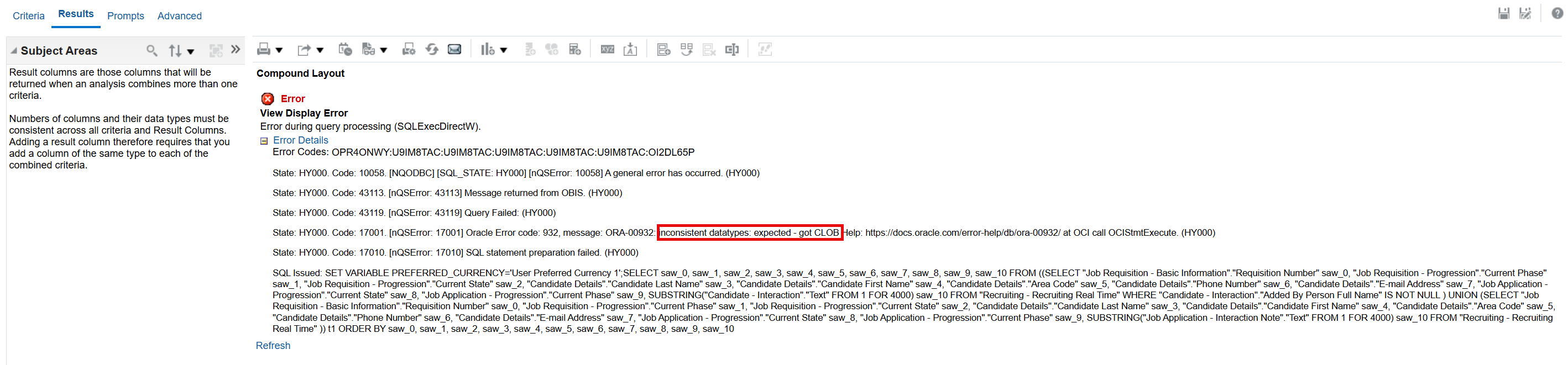

However, when I navigate to the Results tab, the analysis returns the following error: "inconsistent datatypes: expected - got CLOB"

Hi @Ulitka,
Can you please try following formulas in the corresponding Text columns and see if it is executing without error or not?
CAST(SUBSTRING("Job Application - Interaction Note"."Text" FROM 1 FOR 400) AS CHAR(400))
CAST(SUBSTRING("Candidate - Interaction"."Text" FROM 1 FOR 400) AS CHAR(400))Hope this help.
Thank you.

Thank you very much, this solved the problem!
1 -
