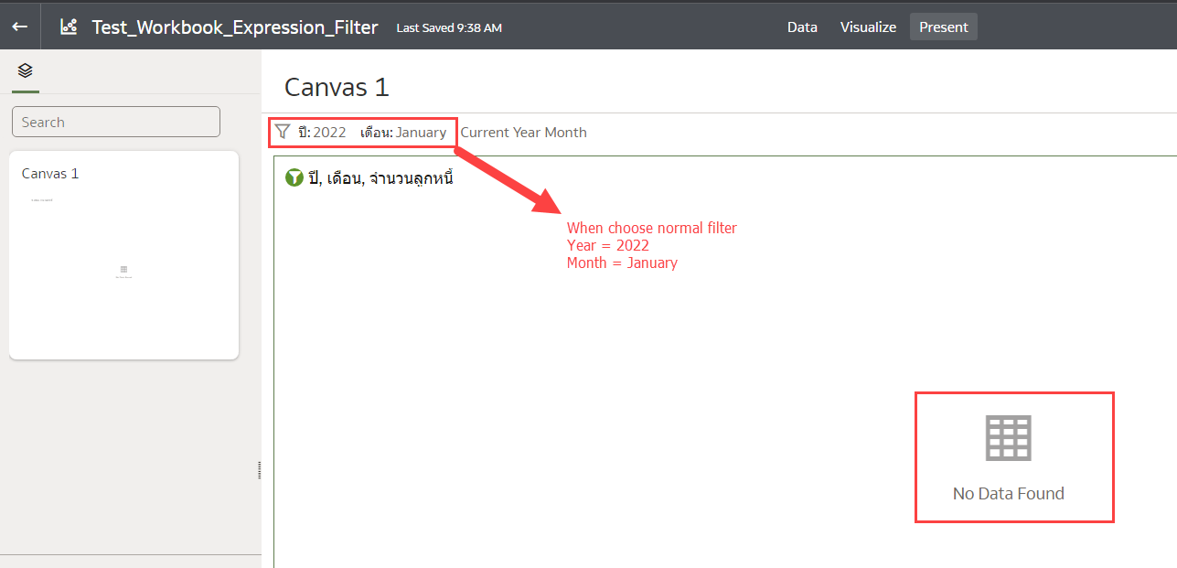

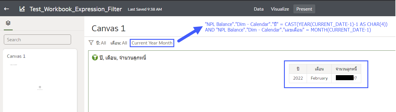

  • NCC
    NCC Rank 2 - Community Beginner
    1.) Workbook have Expression Filter with result of Period = Feb-2022
    and Normal Filter
    Year = ALL
    Month = ALL
    2.) If I need to view date of Period = Jan-2022
    I was choose Normal Filter
    Year = 2022
    Month = January
    After that report result display No Data Found.
    Because Workbook Filter condition was combine both filters like below.
    Period = Jan-2022 (from point 2.)
    AND Period = Feb-2022 (from point 1.)

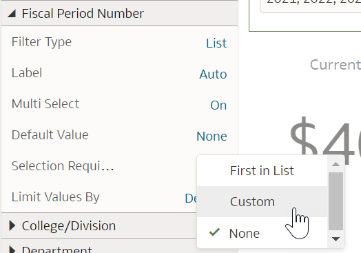

  • Greg Holland
    Greg Holland Rank 4 - Community Specialist
    @Avinash Krishnaram-Oracle While the parameter feature does mostly allow default values in filters, it is still a very messy solution that is not easily implemented. Having to use a logical SQL statement instead of just selecting a server variable name is sometimes difficult.
    Additionally, even when creating these default values with parameters, the fact that the filter value list does not change based on other selected prompts is not workable. In classic, if I set a default value using a server variable that works and the list of available values will change depending on other filter/prompt values selected.
    For example, our business unit structure at UTA goes College/Division -> Department -> Cost Center. By default, we show people the data for their single department using a server variable on all Classic dashboards. They could then set the College/Division to their unit, use the drop down on Department, and only see departments in that College/Division. Likewise, if they used the Cost Center prompt drop down, it would show only the cost centers belonging to the selected department. Using parameters to set the default value on an on-canvas filter ignores the other filtered values and does not impact them and what they show either.
    This same level of functionality is still needed in DV. Ideally, we should be able to select Server Variable in the Default Value for an on-canvas filter in the settings pane, shown in the screenshot below.
