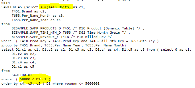

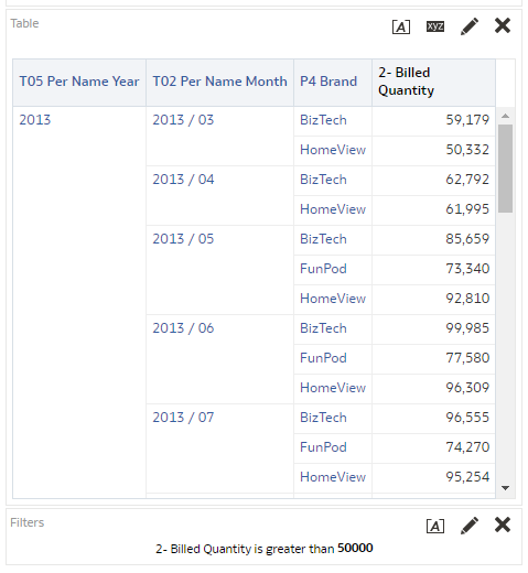

    You shouldn't care about grouping rows, because that's what the product does by default as soon as you do select a measure.
    I finally got my hands on an environment to do a quick test: selection steps works but are generally used for operations on the dimensions.
    In your case the filter on the measure should work...
    The filter on the "2- Billed Quantity" is understood as being a filter on an aggregated measure, and the tool should translate correctly into a post-aggregation query.
    The first part of the query does the aggregation, then the filter is applied on the result of the aggregation.
    This is at least how OAS 2023 handles it, not sure about what version your OBI is.
    Look at the generated query and if it doesn't behave correctly you maybe have issues in your model?

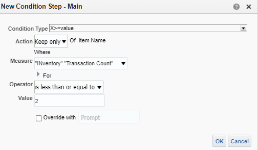

  • Mariyam129
    Mariyam129 Rank 2 - Community Beginner
    edited Aug 14, 2023 10:07AM
    Hi,
    Thank you, @Gianni Ceresa ! I am now attempting to use selection steps to complete this task. However, it does not seem to apply the condition when I press ok.
    Is there something I am configuring wrong here?
    Also, what would be the method to group rows the way that you have mentioned?
