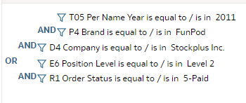

Creating an HR Analysis using column filters, toggling to convert "OR" to "AND" doesn't work
Using the column filter interface, I need to set an analysis that may be as simple as...
Meets condition A
AND meets condition B
AND meets condition C
OR meets condition D
AND meets condition E
When I first emplace the filter for condition D, it starts as an "AND" statement. When I click on the "AND" to convert it to "OR", the line for condition D gets demoted and grouped with condition C. As such, it seems the interface will not permit creation of multiple independent grouped conditions like the literature indicates can be done.
We've just migrated our LMS over to Oracle Learn, so maybe I'm missing something? Any help/guidance is most appreciated because we have many complex training assignment audiences that will be unnecessarily "heavy" to create and maintain in SQL. Thanks in advance.

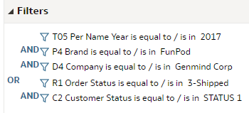

Here's a screen shot of how this plays out...
When I click on the "AND" to create the new "OR" condition and establish a new grouped set of conditions, it ends up like this...

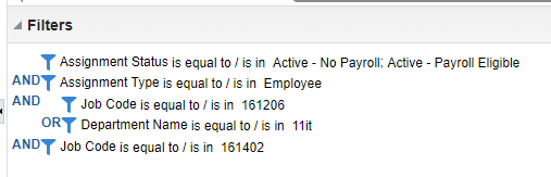

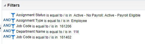

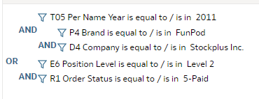

It's doable via the GUI, but it does look "less clean" and it's a bit less intuitive to achieve:
These are just all equivalent from a functional point of view.
Click on the first 2 (on top) "and" to make them "or", the same on the last (bottom) "and". Then click on the last "and". Finally click on the 3 "or" that should become a "and" (the first 2 and the last one) to change them.
And you get it, but it just make you think twice when you are doing the clicking and it also look less intuitive:
A and B and C==(A and B) and C==A and (B and C), but seeingA and B and Clooks more natural than the other 2.0 -
