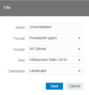

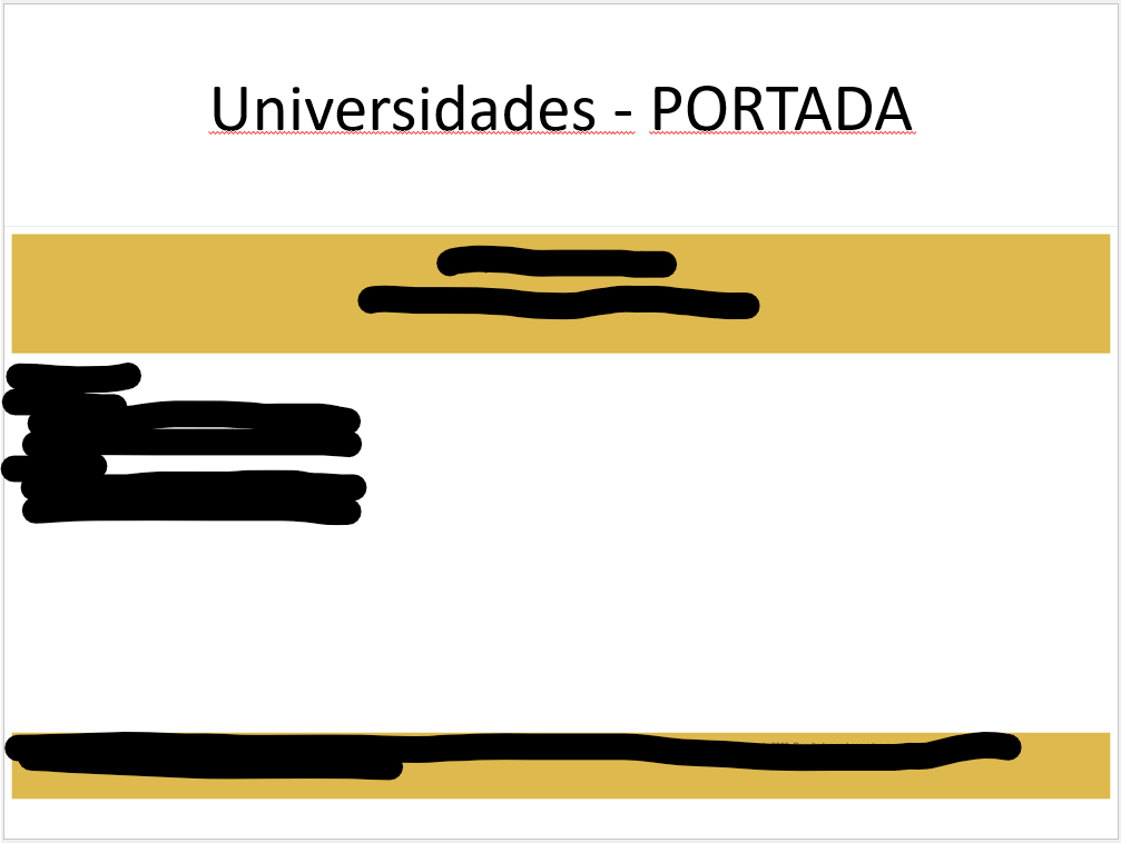

When I Export to PDF or PPTX in DV the file generates with Project Title and Canvas Title.
Is there some option to Configure the Export and delete these titles?
Thanks

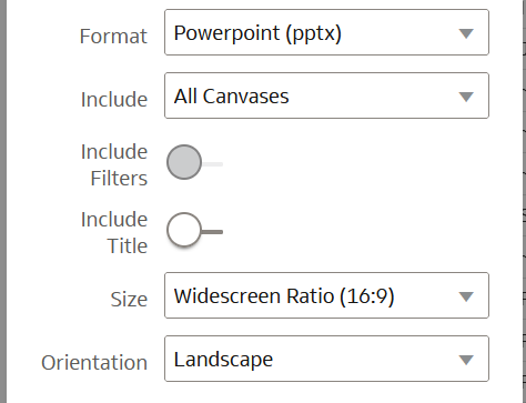

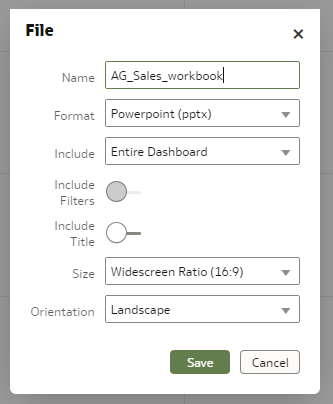

This is a screenshot of OAS 7.0

While exporting DV workbook report below are the default options. If you want to include you need to enable the same.
By Default - Include Filters
- Include Title

Thanks for the answer, but I don't have that options when I export the project.
Regards

I am using OAS 5.9 version.
If I have not that option, Is there another option to Configure the Export and delete these titles?
