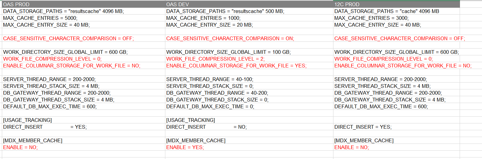

    I have tracked same report with two options, with and without SET VARIABLE OBIS_REFRESH_CACHE=1 in the Prefix section in OAS PROD, OAS DEV and 12C PROD environments.
    We migrated to OAS in new VMs with same  metadata (RPD). In 12c PROD the physical table is cacheable and not in OAS PROD.
    I compared the significant time between the steps I found the most difference is that the cache time in OAS DEV is much smaller than those in PROD.
    Detail shown below;
    I compared the  NQSConfig.INI they are some differences.
    I think CASE_SENSITIVE_CHARACTER_COMPARISON caused the slow cache elapsed time. Not sure WORK_FILE_COMPRESSION_LEVEL has affect to the slowness either.
