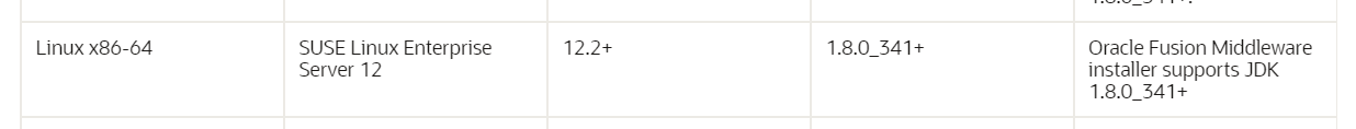

    @Martijn Ceelen, iConsultancy, OBIEE Consultant - As per the certification matrix of OAS, it's not certified/tested with SUSE 15. Supported version details are as below:
    Reference : https://docs.oracle.com/en/middleware/bi/analytics-server/administer-oas/certification-systems.html#GUID-BD72F48C-3DF8-4B9E-81AB-23164B497AB4
    Oracle recommends using certified versions of the operating system and other associated artifacts to avoid such issues.
