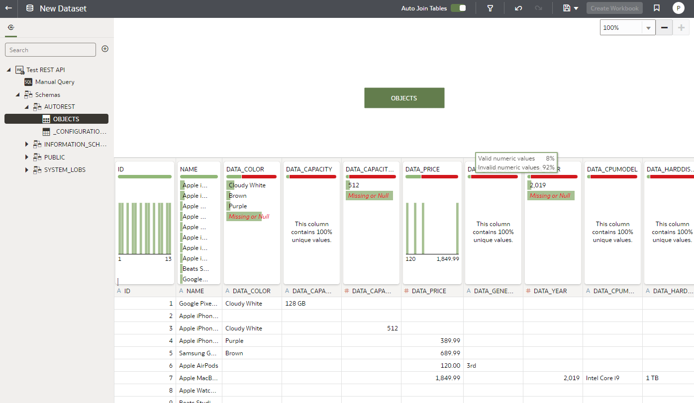

  • I just created a test connection in a OAS 7.6 (aka 2024) and it does work.
    I googled for a random free REST API for testing, found https://restful-api.dev/ , used https://api.restful-api.dev/objects as endpoint and it does just work.
    You could maybe share what you did, how, what you get back as message etc.

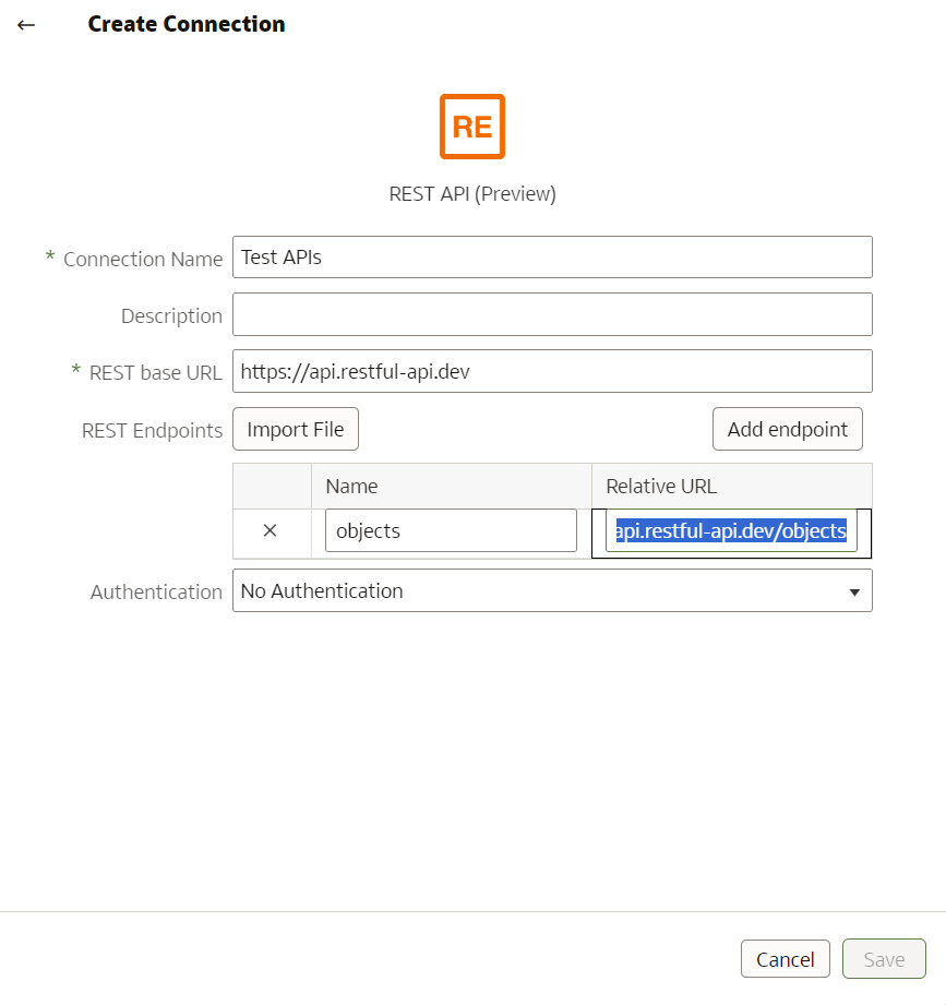

    @Gianni Ceresa Thanks for providing the details. I did the exact same thing you did but the 'save' button just won't enable for me. Below is the screenshot:
    Any idea what might be going on? Thanks!
  • Gianni Ceresa
    edited Sep 5, 2024 8:12PM
    Ah, that :D
    Well, that screen is … buggy. I had the same, and at one point my endpoint was showing twice. I tried to delete the second endpoint a few times, didn't work, so I started clicking everywhere in the page to see if my browser was frozen, and I even clicked on the "back" arrow (top-right in the popup).
    At one point I got a message that my connection was saved and everything was just working.
    The connection page has some issue, that's a thing.
    I just tried again: try to press the "Enter" key on your keyboard after entering the endpoint relative URL. Press it once or twice (or more), you should see a loader bar on top and after some time (there is call in the background doing something) it will save the connection.
    It definitely looks like a GUI issue (weakness), maybe linked to the fact it's still a "preview" feature.

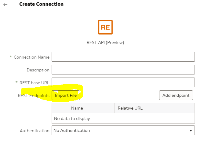

  • Just a random guess: maybe try with a JSON file defining the endpoints: https://docs.oracle.com/en/cloud/paas/analytics-cloud/acsds/specify-rest-endpoint-connection-details-json-file.html (If you need more examples you can find some at https://www.oracle.com/business-analytics/data-visualization/connectors/ )
    Maybe that connection page expect mostly a JSON file with the endpoint configurations than entering them manually.

    @Gianni Ceresa It is doing the exact same thing to me. If I will add another random endpoint, the save button gets enabled. I will try to click around and see if I can save the connection too. One of the use cases I am trying to leverage the REST API endpoints for is to make the connection to ServiceNow data. I tried using the REST API Connector template provided by Oracle but I am unable to establish the connection.
  • Long story short: import a file with your REST connection details and it works fine (the info from the file will be filled in the various fields and the "Save" button is clickable).
