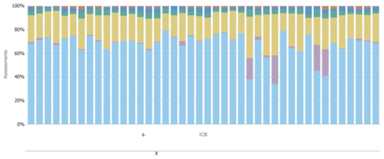

Currently in Oracle Analytics Cloud, stacked 100% bar charts aren't able to be sorted by category, for example, if the percentage of apples and oranges by distributor was being reported on and we were more interested in the percentage of orange we would want to sort oranges high to low. We might also want to highlight a particular distributor which isn't currently possible.
Please can it be looked into:
- The ability to so sort a stacked 100% bar chart by category
- The ability to highlight a particular category to a user to draw their attention and pull focus
And example of the chart type is attached - ideally we would like to either highlight where the x is (a separate chart was created to create the x and add this), and sort by the blue category high to low:

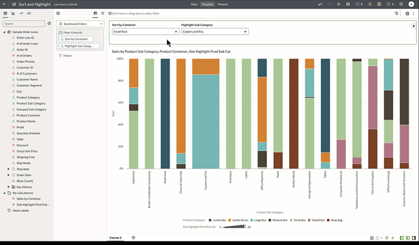

My bad. Disregard the reference line for now. Currently, we can parameterize it only if the category is of a Date data type, but in your case, it is not. Sort should work if you set it up correctly, and I also have an idea for you for the highlight. Here is the example I built. I'm using two selectors to change the sort value (based on containers, which are my colors) and the highlighted sub-category (which is my X-axis category).
Here is the DVA for you to look around
It is not very polished, e.g., I would remove the legend and use a separate legend control to show only the containers, but I think it's a possible example to what you are trying to do.
