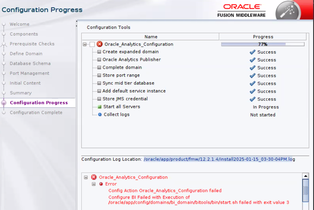

Hi, I'm installing OAS 7.6 in RedHat 8.10 but the config.sh script failed at 77% of the installation process.
I would appreciate any help you can give.
Nelson (@nedcodes), This is likely something server specific (network config, firewall, virus scanner, apps not running, etc.) The logs loaded to the SR indicate a potential connectivity issue <Bootstrap unable to get a direct: 't3'connection to: '0B:XXX.XX.XX.XXX:[9502,-1,-1,-1,-1,-1,-1,-1,-1]:inetAddress=server.domain/XXX.XX.XX.XXX' on port: '9502'java.rmi.ConnectException: Destination XXX.XX.XX.XXX, 9502 unreachable.; nested exception is: java.net.ConnectException: Connection refused> Your support person will follow-up in the service request with some additional data collection specific to your server.
For future discovery, the root cause was a server network configuration. A mismatch of the fully qualified server name and the IP address configured in the /etc/hosts vs the DNS resolution (as evidenced by DNS lookup and reverse IP lookup — nslookup <servername> and nslookup <IP address> )
I had some network problems, fixed them, and restarted the installation process without any problems. Thanks for you support.
Hi @User_DD65B
Can you share your installation log files for Review ?
Regards,
Arjun
@User_DD65B - Can you provide an update or close the thread, please. It appears the installation was successful, but the staring of the processes failed. There can be many root causes for this (from low memory, file descriptors to OS configuration), so it would be helpful to review the logs. You can try to restart them manually in the background [DOMAIN_HOME/bitools/bin/start.sh
Hi @Mallikarjuna Kuppauru-Oracle, Thanks for your answer, I attached the installation log.
Hi @SteveF-Oracle,
Thanks for your answer, when I try to start the process again using the start.sh script, I get the same result.
We would need a diagnostic dump for the details of each componentCollect Diagnostic Bundles Additionally, other details about the server may be required resolve the issue (such as OS details, memory/cpu/ ulimits, etc). Some of these details expose information about your server and may be better suited for a service request so a support agent can review the details. If you want to post the diagnostic dump here, then I can take a cursory review
I have an open SR with this issue from last week. My environment server has the follow details: RAM : 32GB SO: Linux RedHat 8.10 CPU: 64
@User_DD65B Please share the SR#. Thanks!
This's my SR
Severity 3: SR 3-39380479391 : Installation failed - Oracle Analytics Server
The log you uploaded mentions some others that may have more detail. Do they give any insight or point to which component failed on startup? eg bi_server1,obis1,obips1,obijh1 etc
