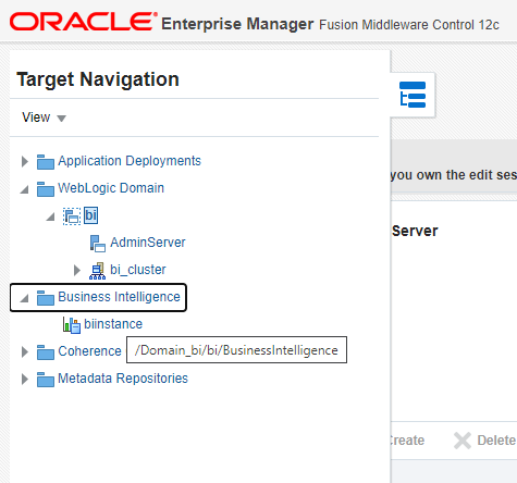

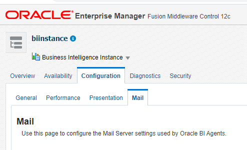

Ok, my bad, apparently the SMTP settings in OAS are still (up to 2024) in the EM Fusion Middleware Control (OAC is in DV console, and OAS 2025 could also be the same).
https://docs.oracle.com/en/middleware/bi/analytics-server/administer-oas/configure-email-and-agents.html#OASSG-GUID-4693A721-2030-4244-9157-83A199AF66A0
By default it is available on <your OAS>:9500/em
(Click on "biinstance" and not "Business Intelligence")
