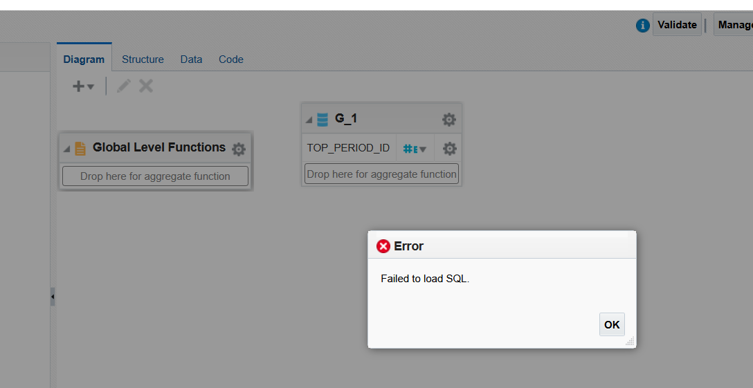

    Additionally, we are encountering a strange error that we have never seen before: "Failed to load SQL." This occurs when we try to create a Data Model with a simple query like "SELECT DISTINCT TOP_PERIOD_ID FROM CMP_CWB_HRCHY_CF_DN" or "SELECT DISTINCT TOP_PLAN_ID FROM CMP_CWB_HRCHY_CF_DN."

    I have conducted several tests, and I am encountering the error exclusively with the CMP_CWB_HRCHY_CF_DN table. Specifically, the error arises when I use fields that start with "TOP_", such as TOP_MGR_PERSON_ID, TOP_MGR_PERSON_EVENT_ID, TOP_PLAN_ID, or TOP_PERIOD_ID.
    I can create a Data Model without any issues using queries like "SELECT * FROM PER_ALL_PEOPLE_F" or "SELECT * FROM CMP_CWB_HRCHY_CF_DN." However, when I attempt to create a Data Model with a SELECT query that includes any of the TOP_ fields (e.g., "SELECT TOP_PERIOD_ID, PERSON_ID FROM CMP_CWB_HRCHY_CF_DN"), I receive the error "Failed to load SQL." In contrast, if I use a query like "SELECT PERSON_ID, HRCHY_CF_DN_ID, ASSIGNMENT_ID FROM CMP_CWB_HRCHY_CF_DN," no error occurs.
    Once I receive the error, after the click on the OK button in the DataSet, the Data Model becomes unusable, and I have to reload the page.
