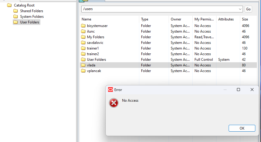

I was thinking of making a new user and deleting the old one, but I don't know how to copy dashboards and reports from the old user to the new one.
In the Catalog Manager I can see renaming user. As you can see I cannot access users's folder!

Also, on your other query : By default Administrator does not get access to users content as users content is meant to be confidential. Please Refer :
OBIEE 12c: How To Update Object Ownership In The Catalog After A User's Name Has Been Modified (Doc ID 2759123.1)
OBIEE: Weblogic User Does Not Have Access To Other User Folders Using "Admin View" (Doc ID 2234422.1)
An Administrator User Cannot Modify Owned Items That Were Created By Another User In Oracle Analytics (Doc ID 2957146.1)
