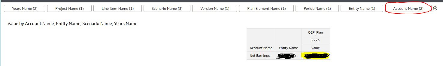

I am able to replicate the smartview, but how to replace 'Account Name' column with 'Account' hierarchy column from the Account dimension? when i replace it with Account hierarchy column, it says 'No Data Found'. I see you have used this hierarchy column in your screenshot.
Below is what i built so far

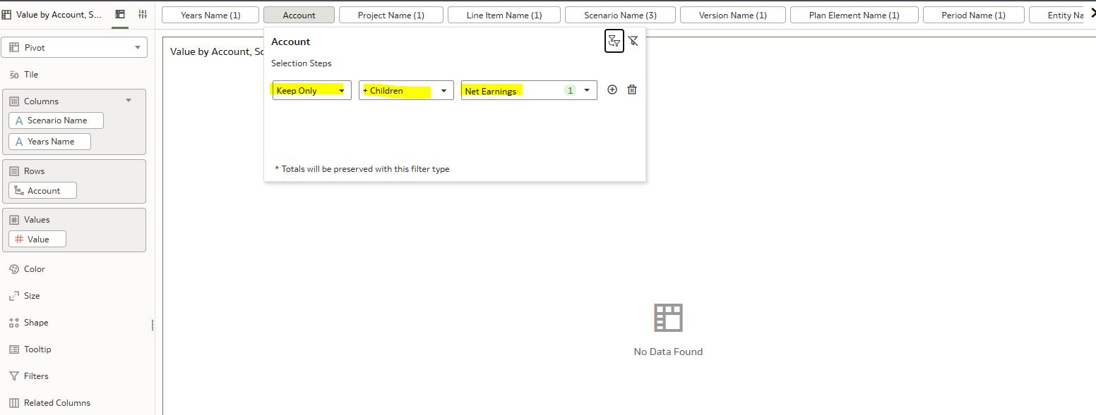

Remove the Account Name Filter. Drag Hierarchy to Filter and use Selection Steps. You might need to enable it in advanced settings
1 -
Ok, will try to find that option and enable it. Thank you @Wayne Van Sluys
1 -
Good Morning, I have enabled the selection steps in the advanced settings and replaced Account name with Account Hierarchy in filters.
I still don't see data, i am i missing anything here?
0 -
Without seeing your workbook and reviewing logs I am not able to help any further.
I would suggest looking at the Developer tab and looking at the physical query that is being generated.0 -
