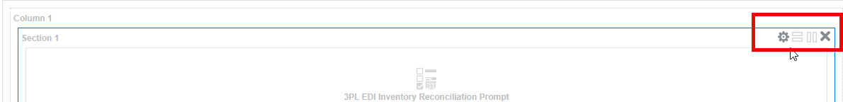

Hi, I'm having issues with adding two sections side by side in a column as whenever i drag the analysis to the column the 1st report able to add without issues but when i try to add 2nd report to the side of 1st of report it moves out of the column to the bottom of the 1st report. I tried but unable to find the solution for it. I have BI Administrator role as well if that makes any difference.
What else would be the issue? Please need urgent help on this.

    Are you clicking on the layout icon on the section upper right to change the layout to horizontal instead of vertical? And make sure you drop the second report into the same section box.

    Thanks Ross for your response. I did that already but as soon as report tried to place to right side as vertical blue sign shows of section it toggles back to vertical layout .. Please see the screen shot attached

    Did you try running it? Sometimes even though the edit screen shows it that way, the reports will show side by side on the dashboard.

    Hi Ross I need to accommodate few more reports for the layout so unable to find room for others unless sections are placed side by side. At the center i need to add three analysis reports in one section.
    But in the attached 2nd picture, even though layout shows reports one below other i can see output with side by side ..
    I need to see visually not to overlap the sections ..so as to accommodate other reports and minimize the space also looking to add header. Currently no space at all. I appreciate your inputs

    Thanks Bhaskar. Resolved issue with zooming out the size.

    Just want to repeat - did you try running the dashboard even though it appeared they were stacked on top of each other? The visual display on the edit screen sometimes does not match what the actual dashboard looks like when you run it - regardless of zooming.

    Yes it works but it will be hard for making changes to layout.
