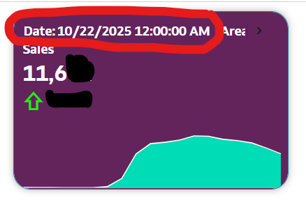

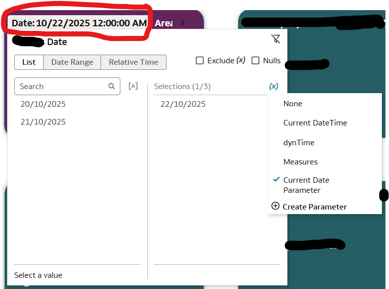

Hii OAC Community. As shown below ,In some of our visualizations ,We have List Filter having Date values of Data type:Date and Format :dd/MM/yyyy .We want to make sure that the selection of Current Date is done automatically .For this we tried with Parameters ,but we couldn't found the current date value as shown below.Pls suggest if this the correct approach ? also how to resolve this .Thank you.

    You’re on the right track by using a date parameter to auto-select today’s date in your filter. For this to work, set your parameter’s initial value to an expression like CURRENT_DATE instead of a hardcoded date. Make sure your dataset always includes today’s date, otherwise the filter cannot select it automatically. If your data sometimes lacks the current date, consider applying a filter expression (YourDateColumn = CURRENT_DATE) or use the Relative Time Filter for best flexibility.

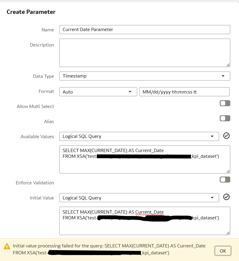

    Hi, to do this please set the data type to Timestamp and Auto, then set the initial value to the following Logical SQL:
    SELECT MAX(CURRENT_DATE) AS Current_Date FROM
    XSA('<REPLACE_WITH_YOUR_DATASET_PATH>')
    You’ll just need to replace <REPLACE_WITH_YOUR_DATASET_PATH> with any existing dataset reference from your environment — that should do the trick.
    I’ve tested it on my end, and it works fine.

    Dear @Jestin Rajan ,we tried with the approach ,however we are getting an error as shown below, Can you pls advise what mistake we're doing ? Thank you.

    Hi, most of it looks good. The only part I can’t verify is whether the reference is correctly set up as the LSQL expects. What I’d suggest is — since the file name shows as _kpi_dataset, please go to Data > (3 dots) > Inspect, and you should find an option to Copy Object ID. That exact ID is what needs to be copy-pasted here.

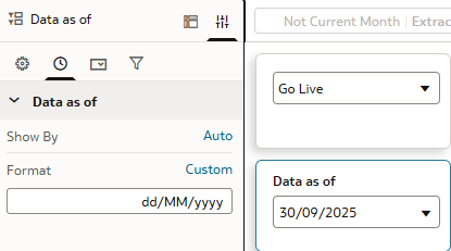

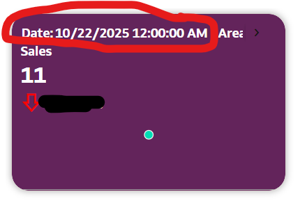

    Thanks @Jestin Rajan ,After using object id ,it's auto selecting the current Date .However it's now in Timestamp Format .We require it in the format :dd/MM/yyyy .We tried changing the parameter Datatype from Timestamp to Date and Format :Custom - dd/MM/yyyy and keeping the same Logical SQL ,but its not working, Pls advise on this . Also find some screenshots below for your info:

    Glad it worked for you, @Hasan Sd ! What I’d suggest is to keep the parameter datatype as Timestamp (Auto), and then go to the visual and change the date format at the visual level from Auto to Custom (dd/MM/yyyy).

    Thanks @Jestin Rajan for the reply .However we are not using Dashboard Filter Type. We are directly using Filters inside Different Visualizations as shown below :In this we can't see any option to change Filter Format to dd/MM/yyyy .Pls advise what we should now do to resolve this :
