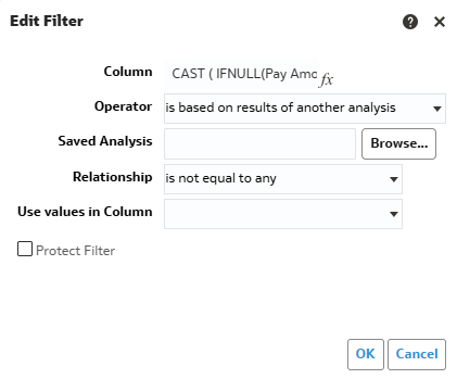

I am looking for a feature 'Add filter based on another analysis'. It exists in classic BI, we are looking for a similar approach Oracle DV. Please let me know how to achieve this
@Bala.01 - Thank you for reaching out on the community.
We do not have this exact feature available in DV, but you can use the Data Actions feature, which offers similar options and may help you achieve your requirement.
You can refer to the https://docs.oracle.com/en/cloud/paas/analytics-cloud/acubi/how-data-actions-affect-filters.html#GUID-41A6D400-C485-44E8-A680-512054263F11 documentation for additional guidance.
Hope this helps!
