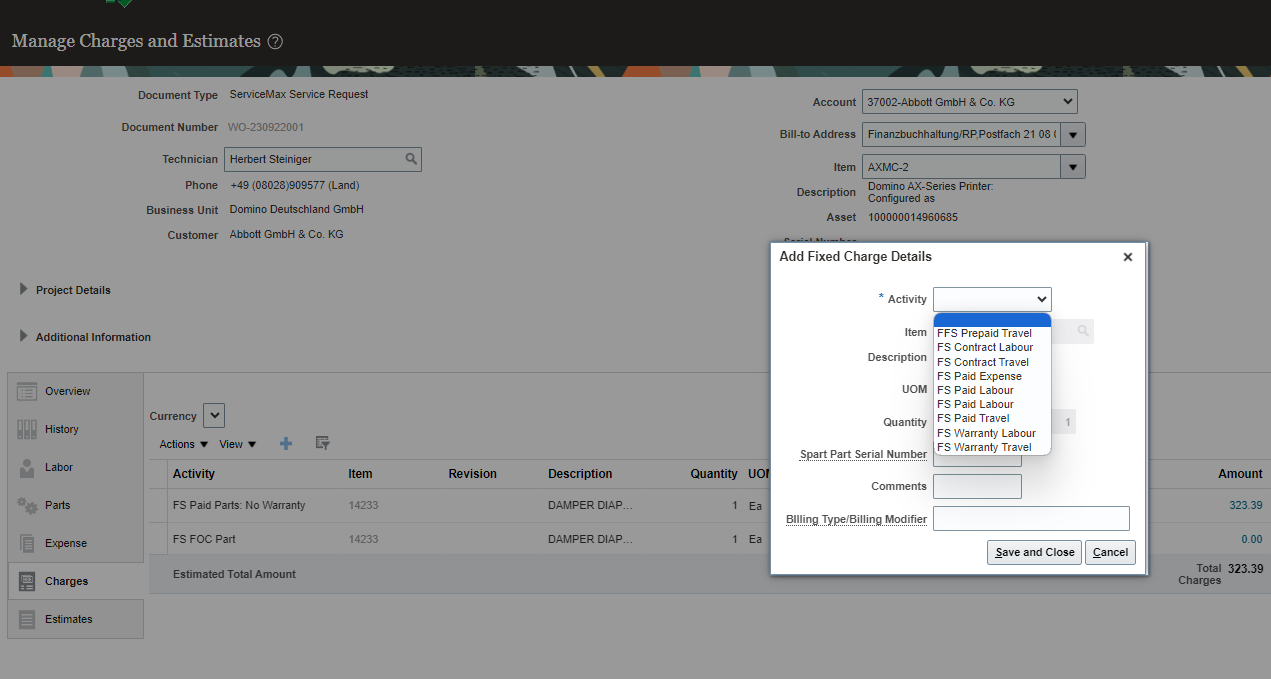

Summary:
I have created a SAC FS_FOC_TRAVEL attached to Billing Type Fixed Charge. It has Zero Charge checkbox checked.
The Billing Type setup for Fixed Charge is also correct.
Now, I expect this SAC to show up in Debrief when I try to add a Fixed Charge, but it does not. See SS below where I do not see FS FOC Travel.

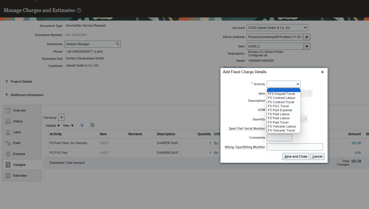

Now I go back to SAC definition and uncheck the Zero Charge flag and Save. Then it shows up in the Add Fixed Charge Details UI
Though its Zero charge, I want to capture this in the Debrief to record that it was actually incurred, but not charged.
