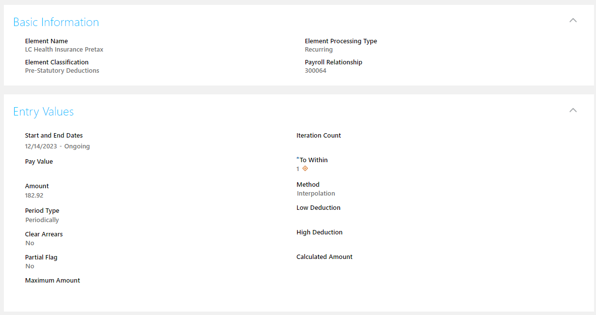

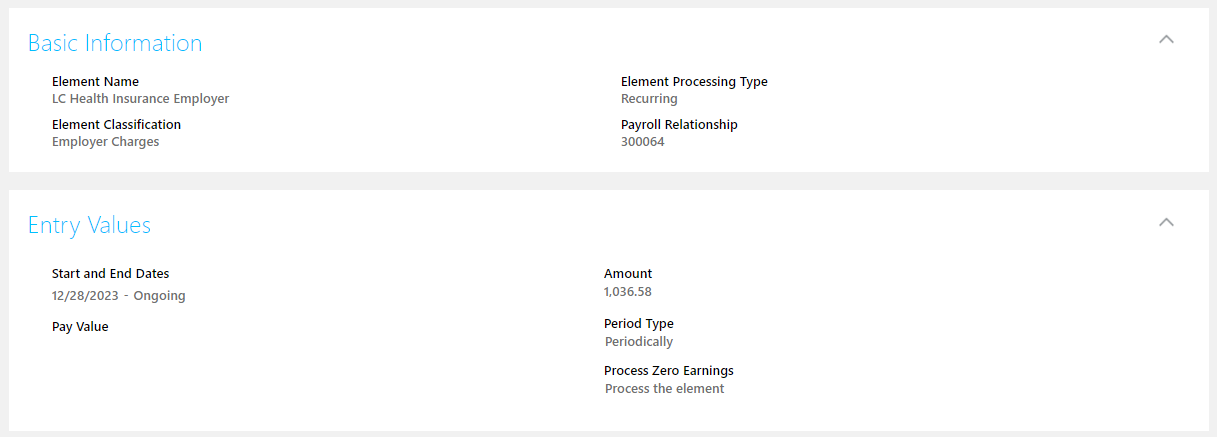

Element Entry ending and restarting with change in value for ER Rate only. New plan effective 1/1/2024. New rate effective 12/14/2023. Payperiod dates 12/14/2023 - 12/27/2023, with Paycheck date 1/4/2024. Using Rate Start Date FF to hard code rate start to 12/14/2023 on Scheduled - Open event.
Why is the EE pretax correct and ER not applicable incorrect? Why is the element entry ending with the incorrect amount and restarting with the correct amount?
Content (required):
View payroll info - EE pretax
View payroll info - ER
Current year - 2023
New rate start 12/14/2023 (1st payperiod for 2024) - Employer Biweekly amount is incorrect. Effective 12/14/2023 should be 1,036.58.
