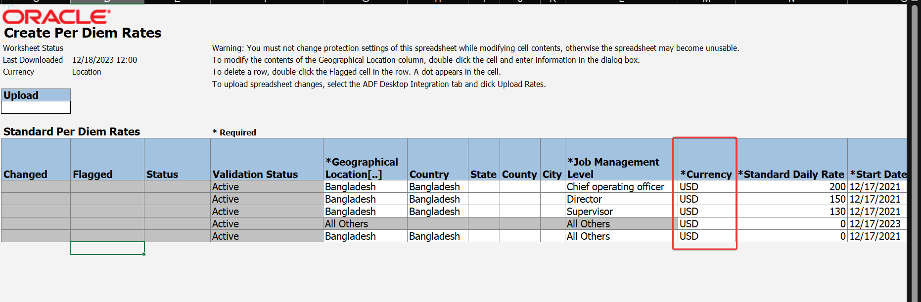

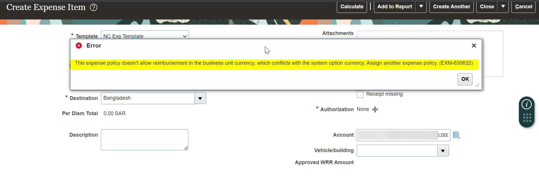

Question: There is requirement to define per diem policy based on location with different currency and I am using "Location rate currency" in Per Diem expense policy setup, but that is not working and I am getting error when creating expense item in report- This expense policy doesn't allow reimbursement in the business unit currency, which conflicts with the system option currency. Assign another expense policy.
Expense Policy setup:
Rate created thru sheet:
I gone thru Per Diem Functional Overview (Doc ID 2397505.1) and several other documents but no help.
Can anybody provide any guidance/ document on how to setup expense policy in above case so that I can figure out where exactly I am missing setup/ configuration?
