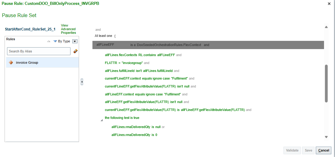

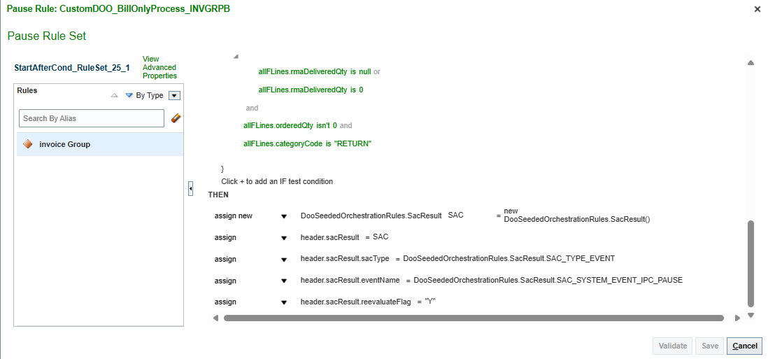

Hi,
we return Good from customer by 2 option, - return for credit and return for Credit and return the item
the business requirement is that i should enable them to Pause the credit line or retrunable line till all lines that are marked together will be returned,
so added pause step as first step for the return fo Credit Process - duplicated from the Bill only Orchestration
the pause rule is:Orchestration
Pause rule
based on samplepauserules document
used - Send group of lines (shippable, non-shippable) to invoicing with
Send all returned lines and: non-shippable lines to invoicing
for creating EFF based pause rule for return lines
