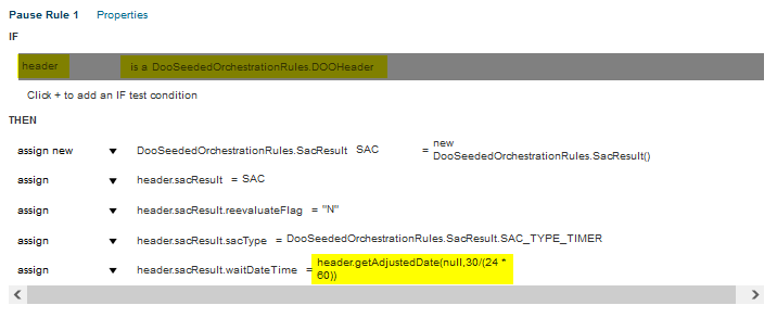

We have a requirement, to pause the order line for 30 minutes based on order submission time
If the submission time is 15:00 Hrs, then order line should be on pause until 15:30 Hrs. and release automatically.
we tried the below code but pause is getting released as soon as it is created, given the setup details below.
Can someone suggest us a solution to implement the pause successfully
