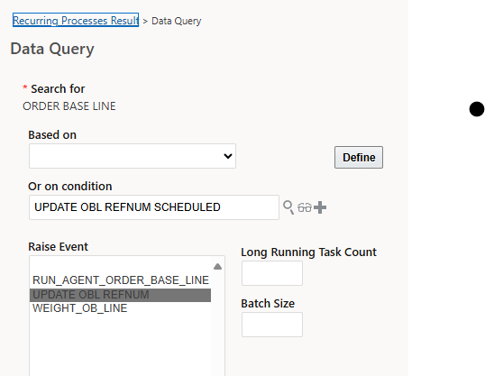

Need to Make Schedule Process that runs every 10 min to copy refnum from order base line to order base
I managed to make the schedule process that raise event and the action of the agent is just copy all refnum from OB_line to OB
The Setup is as follows
1- Create Automation agent with custom event and the action is copy refnum
2- Create Schedule Process on Order Base Line that runs every 10 min to copy the refnum
The Condition is as follows
SELECT ORDER_BASE_GID FROM OB_LINE WHERE OB_LINE_GID IN (SELECT ORDER_BASE_LINE_GID FROM OB_LINE_REFNUM WHERE INSERT_DATE > SYSDATE - INTERVAL '15' MINUTE)
