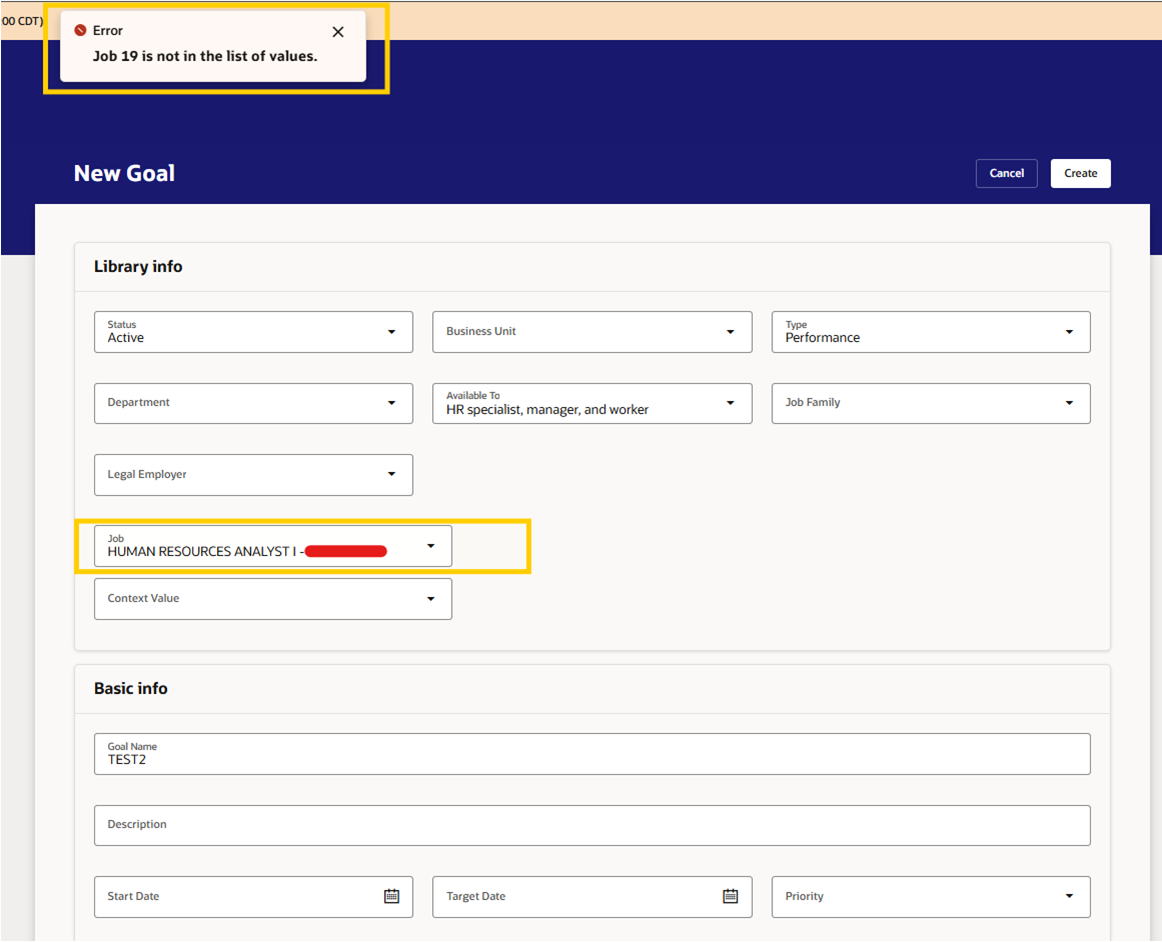

We have a requirement to add a custom Job dropdown field in the following path: My Client Groups > Goals > Performance Goal Library > Add.

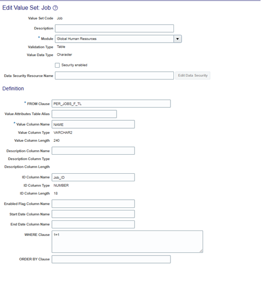

We successfully implemented this using Manage Descriptive Flexfields (DFFs).
However, we are encountering an error when attempting to add a Performance Goal only when the custom Job dropdown is populated—and notably, the error only occurs for certain Job values, not all.
We’ve attached screenshots detailing:
CONFIGURATION
  1. Manage Descriptive Flexfields
Flexfield code: HRT_CONTENT_ITEMS_B

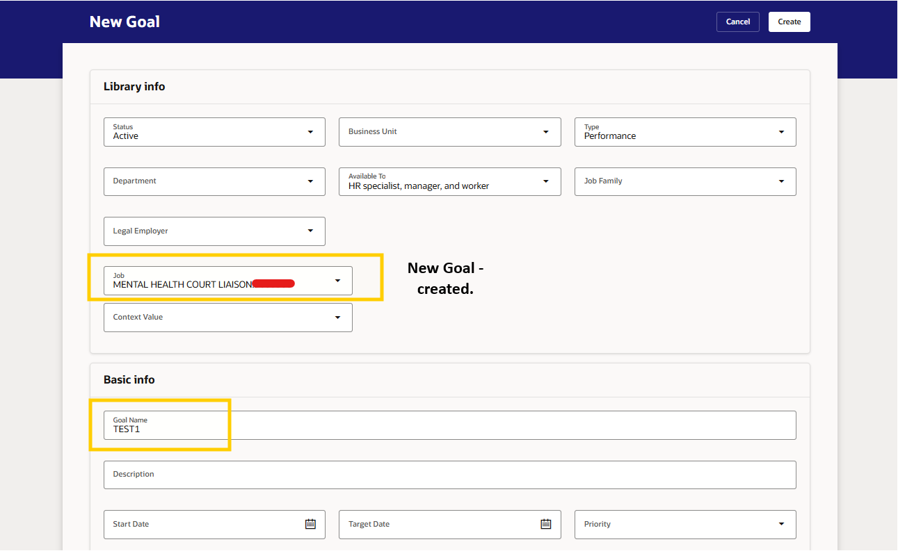

TESTING:

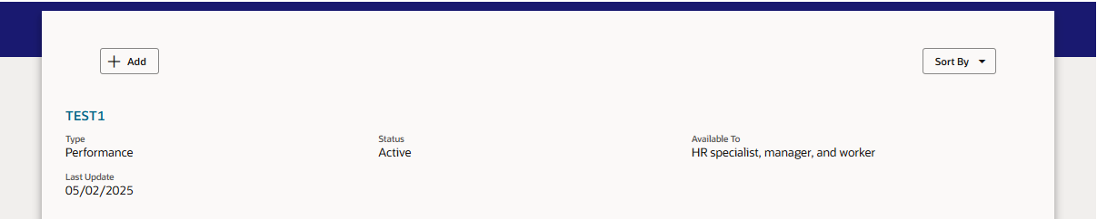

  1. New goal created - without errors
2. Job XX is not on the list of values error
Question:
Could you please assist in identifying the root cause of the issue or let us know if there are known limitations with certain Job values in this context?
