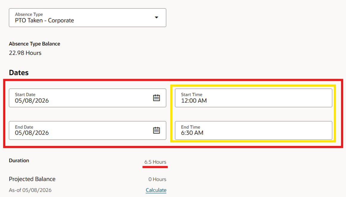

Absence duration shows 0, when an overnight employee applies for absence
We recently implemented Oracle time and labor. We have a team of employees that work in overnight shifts (10:00 PM - 6:30 AM). When one of them applies for absence for the whole hours, the duration shows 0. The duration gives the correct numbers if the absence is broken down into 2 records.
  1. 10:00 PM - 11:59 PM (1.98 hrs)
  2. 12:00 AM - 6:30 AM (6.5 hrs)
I attached the screenshots on how it is working for additional information.
Have anyone encountered this issue before or can you suggest on how to work through this one?
How the system wants us to submit absences:
I also want to note the workday configuration is as below:
