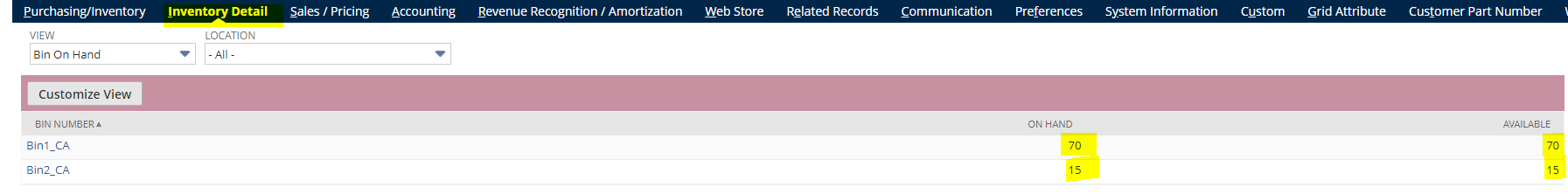

My sample Bin Item has 75 on Location on Hand:
But my sample Bin Item has 85 in under Inventory Detail subtab:

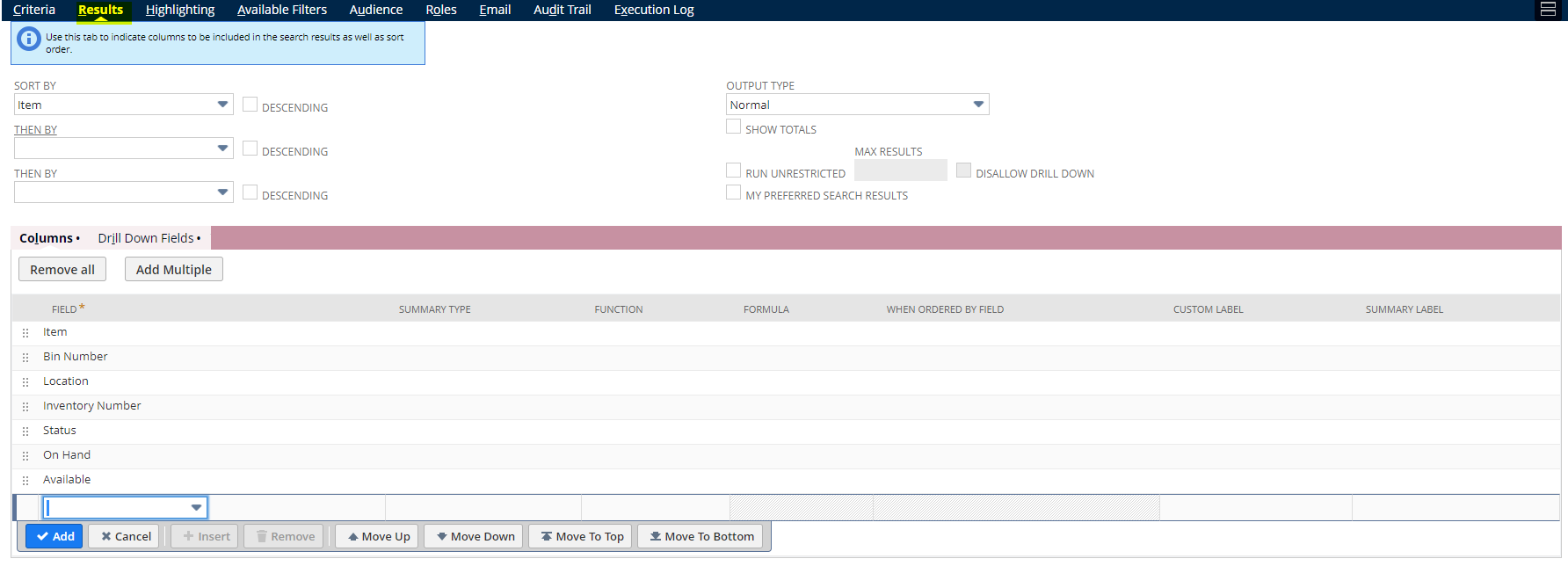

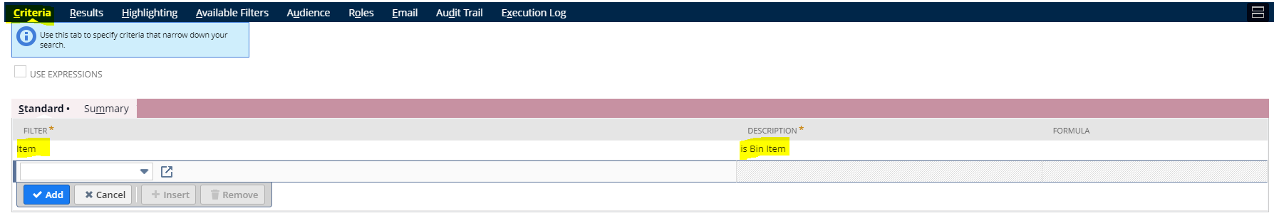

I ran the Inventory Balance Search with below Criteria and Results tab:

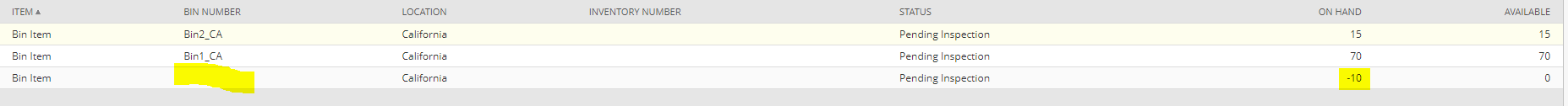

And here's the result:
Here you will see that there was a negative movement in my sample Bin Item but the transaction had no Bin. This means that the Bin details is not populated in the transaction record.
I looked at the related records and I saw that there was a negative inventory adjustment that had no inventory detail. Putting the Bin details in the record would resolve the mismatch.
