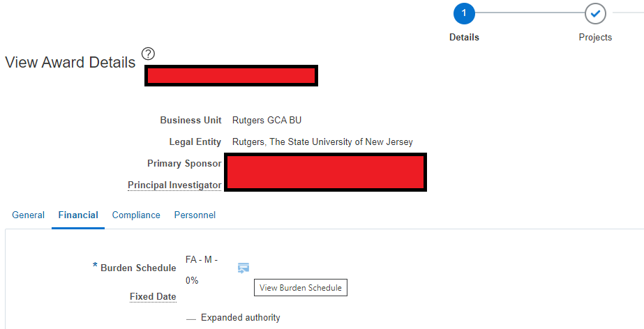

You also may need to look from the award side, sometimes there is an override multiple from award to project. That is under Manage Awards, search for the award first, -> View, then in 2nd tab for projects. You'll see the multiplier setup for the award, but keep in mind rate can also be overridden by project.
Also double check the award setup itself

@Rich Merkel thanks yes we started with total committed costs but that is the total for all POs and doesn’t take into account the spend down.
i checked and the amounts for burdened and non-burdened are the same in the manage project costs screen.
