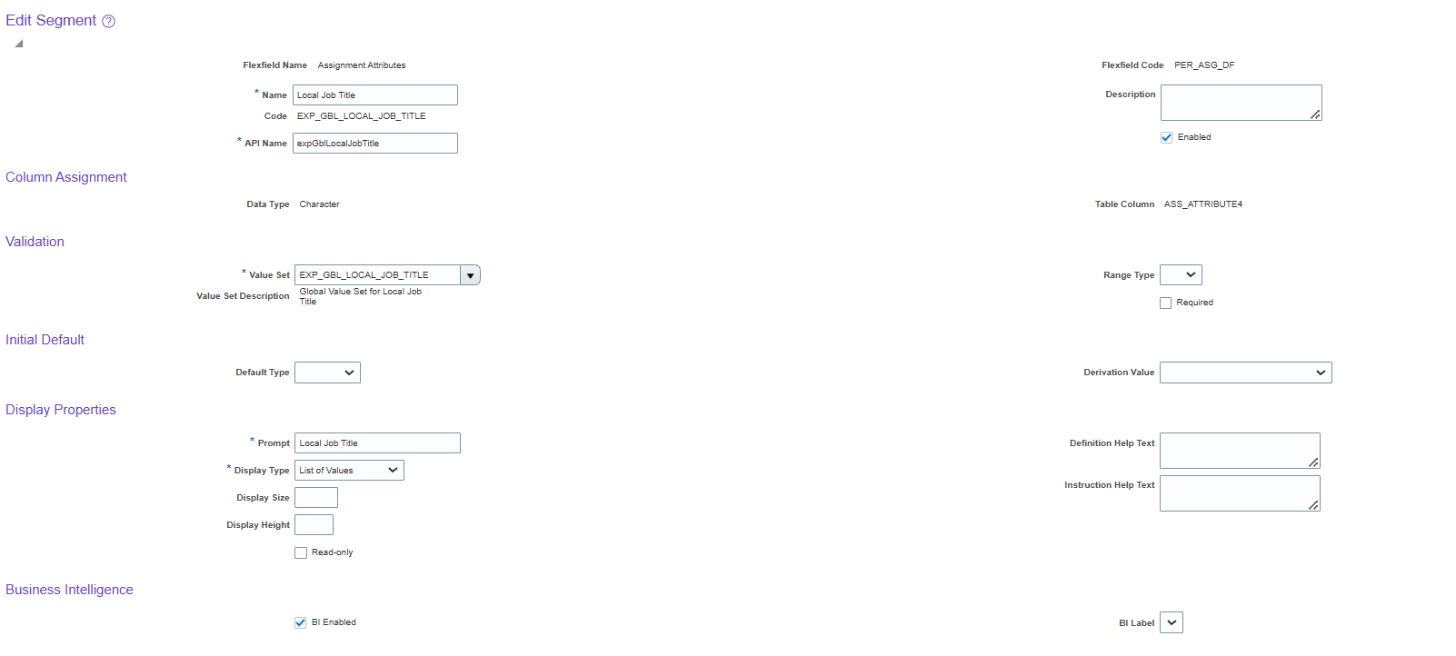

@MandeepGupta yes, we have run the second job by checking the HCM checkbox. The strange thing is that some other fields seem to work correctly with code , description and translated value columns. But it is not working for only specific fields.
1 -
Are you able to see any difference for this attribute from other attributes in the DFF setup? if possible, can you share a screen shot for this DFF setup?
Thanks.
1 -
@MandeepGupta HI, I don't see any specific differences. Below is the current setup.
1 -
This is strange. Can you confirm if display type is same for other attributes where you can see data?
Thanks
0 -
