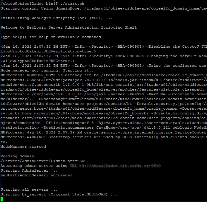

But this time, when doing our final reboot of our server it looks like its getting stuck on "Starting bi_server1"
We are just using the start.sh script.
Node manager, and Admin server both seem to start up fine.
It just goes to "Starting bi_server1" and seems to freeze.
I'm quite sure its frozen as I was rebooting it right before I went home from work. Next morning when I came in it was still "stuck" on trying to start bi_server1.
I tried checking the log files but I dont see any immediate error messages.
I did try looking at a few log files, one of which included - bi_server1.out - But again I didnt see any immediate error messages.
I was wondering, has anyone else experienced a similar issue after migrating their OBIEE RCU schemas?
Are there any particular log files that I can try to look at? Not sure if there's a specific few I should focus on?
I apologize if I sound vague, its just that since it literally "froze" and does not appear to be even giving an error message Im not sure how best to trouble shoot

    I was able to finally find what the issue was - Apparently a very silly mistake.
    In the MOS document I linked to earlier - In the section titled:
    Installing New RCU Schemas In The New Oracle Database
    There is a step where it states to bring data over from the old schema to the new target schema for these tables
    BIEE_BIPLATFORM.S_NQ_DSS_SERVICE_STRIPES
    BIEE_BIPLATFORM.N_NQ_SEARCH_CRAWL_CONFIG
    BIEE_BIPLATFORM. S_NQ_DSS_IDENTITIES
    I double checked the above specified tables and apparently the data was not there. I'm guessing some one maybe didnt COMMIT; after moving the data over 😋
    But anyways - Once I brought the data over to these 3 tables from the old schema to the new schema - Everything booted right up as usual.
    I did try to create a ticket to Oracle Support and also posted in the MOSC forums but didnt get any answers. I also dug through all the logs while we were having this issue and there was NO error messages that I was able to find which made this very hard to figure out. I dont think Oracle support really had an answer either. I will also update and close my other open threads
    So it was a lucky thing I double checked these tables. But just wanted to post an update in case this helps someone else out there.
